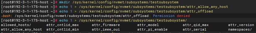

I have a question about setting up nof targets on CX6 network cards now. I have an MCX631102AN-ADAT network card installed on my server, with the operating system openEuler 24.03, kernel versions 6.6.0-28.0.0.34oe2403.aarch64, and a 3.0 version of doca-ofed installed on the host.

Use the following link to build a nof target. EnterpriseSupport .
When I execute dnf - y install doca all on the command line and then execute/etc/init.d/openibd restart, there are no errors generated when executing modprobe nvmet and modprobe nvmet rdma. To prevent loading old modules with new drivers, I also executed dracut - f to update initramfs, and then restarted the operating system. But when I create a subsystem according to the link, it prompts permission denied.

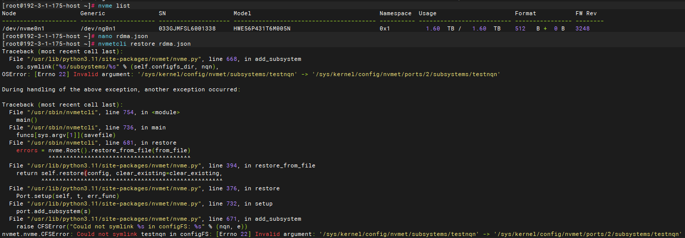

Even when referring to the official Red Hat link for interactive configuration, errors still occur. The link is as follows: 11.3. 使用 nvmetcli 设置 NVMe/RDMA 控制器 | 管理存储设备 | Red Hat Enterprise Linux | 9 | Red Hat Documentation

[  195.905583] nvmet: adding nsid 1 to subsystem testnqn
[  195.910032] nvmet: transport type 1 not supported
I noticed that the driver used by the article in the link is still mlnx-ofed, and the installation comes with the parameter --with-nvmf. How can this parameter be enabled when installing on doca-ofed? In one topic, I noticed that doca-ofed has abandoned the with-nvmf parameter and integrated it into doca ofed. However, the problems in actual use are still the same as those in installing mlnx-ofed without this parameter. How to solve the above problems?
Thanks for your question.
mlnx-nvme package provides nvmet module with doca installation.
i.e.
[root@l-csi-host-04 ~]# modinfo nvmet | grep file
filename: /lib/modules/4.18.0-477.13.1.el8_8.x86_64/weak-updates/mlnx-nvme/target/nvmet.ko
[root@l-csi-host-04 ~]# ls -l /lib/modules/4.18.0-477.13.1.el8_8.x86_64/weak-updates/mlnx-nvme/target/nvmet.ko
lrwxrwxrwx 1 root root 70 Jun 30 10:58 /lib/modules/4.18.0-477.13.1.el8_8.x86_64/weak-updates/mlnx-nvme/target/nvmet.ko → /lib/modules/4.18.0-372.9.1.el8.x86_64/extra/mlnx-nvme/target/nvmet.ko
[root@l-csi-host-04 ~]# rpm -qf /lib/modules/4.18.0-372.9.1.el8.x86_64/extra/mlnx-nvme/target/nvmet.ko
mlnx-nvme-24.04-OFED.24.04.0.6.6.1.kver.4.18.0_372.9.1.el8.x86_64.x86_64
For more info please look at DOCA documentation:
