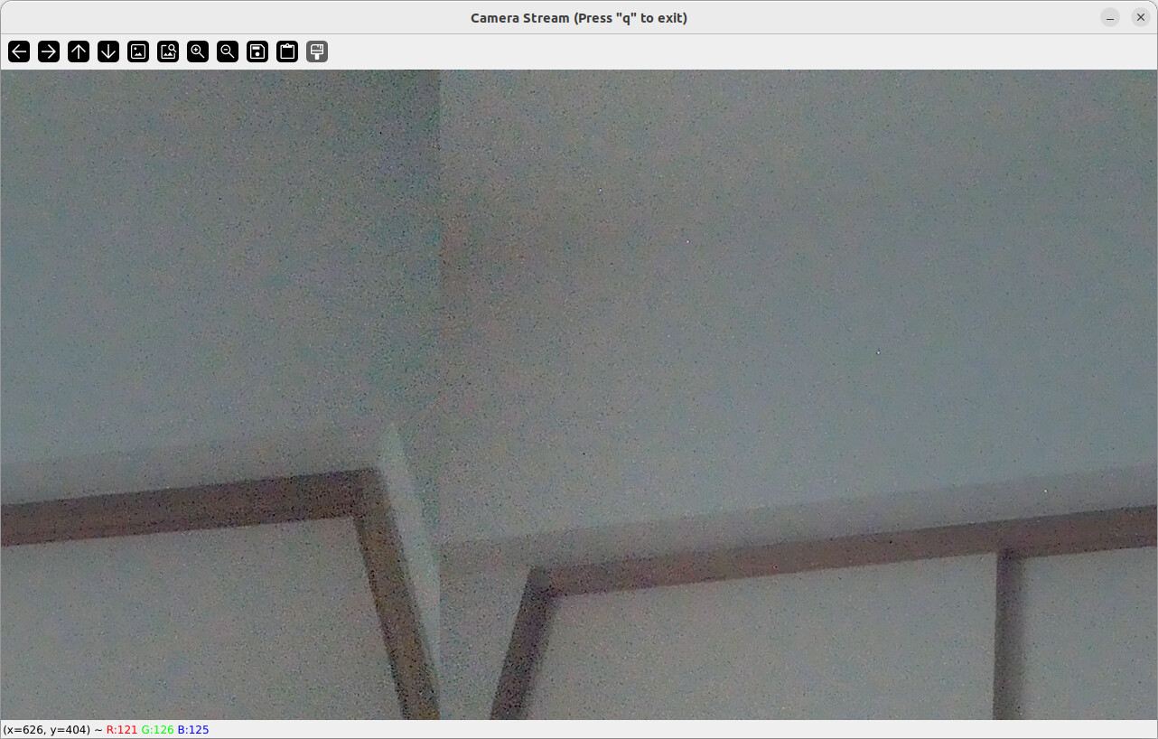

I am currently trying to use a CSI camera on my system. I was able to display the video feed by executing GStreamer via subprocess and reading the raw data from stdout into NumPy.
(The colors are correct with both BGRx and I420 pipelines.)
However, the video output is spatially shifted and appears split into two halves, as shown in the attached screenshot.
I suspect this spatial shift is caused by a padding issue (extra bytes at the end of each line). To resolve this, what would be the most effective solution (a workaround or specific setting) on either the GStreamer pipeline side (e.g., in caps or filesink settings) or the NumPy reading side?

Update: I have found a temporary fix for the spatial shift.
By applying np.roll(frame, -486, axis=1) (or +800px) to each frame, the video is now displayed correctly.
The current code is attached below.
This means that the shift is exactly 486 pixels to the left, which is 6 pixels (18 bytes) more than the expected 480-pixel difference (1280 - 800).
This suggests a hard-coded padding of 6 pixels/18 bytes is being added by GStreamer’s filesink or the underlying memory handling.
Could anyone advise on how to eliminate this 6-pixel/18-byte padding in the GStreamer pipeline itself to prevent the shift and remove the need for np.roll()?
Thank you again for your time.

Hello @drufin.iruka,
Couple of ideas:
  1. Can you try capturing with a GStreamer pipeline to remove Python, Numpy and all that complexity from the equation?
gst-launch-1.0 nvarguscamerasrc ! nvvidconv ! ximagesink
  • If you still see the shifting issue. Then the problem is probably a driver problem. Something in the device tree configuration or the camera register table is causing the video to shift.
  • If the problem does not show on GStreaerm. Then the issue is how you are trying to capture using Python.
  1. I believe running GStreamer with subprocess is a bit complicated. I would suggest you use our sample Python script from our How to Capture Images From Nvidia Jetson Using Python wiki.. You can simply comment the print(f"Received frame of resolution: {width}x{height}") line to avoid noise and uncomment the following section:
# Optional: convert to numpy array
# import numpy as np
# np_frame = np.frombuffer(frame_data, dtype=np.uint8).reshape((height, width, 3))
That will give you the numpy array, after that you can simply display it with OpenCV.
