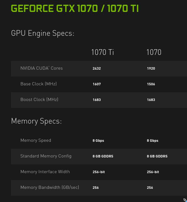

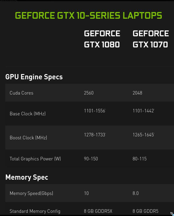

Looks like I was wrong. Number of cuda cores differs.
Here are the specs for both from Nvidia:
Desktop:
[url]https://i.ibb.co/PDKXyz8/1.jpg[/url]
Laptop:
[url]https://i.ibb.co/pfM4p8v/2.jpg[/url]
I guess more cores is not a problem cause I can use the same number of cores as for desktop edition. But clocks…
