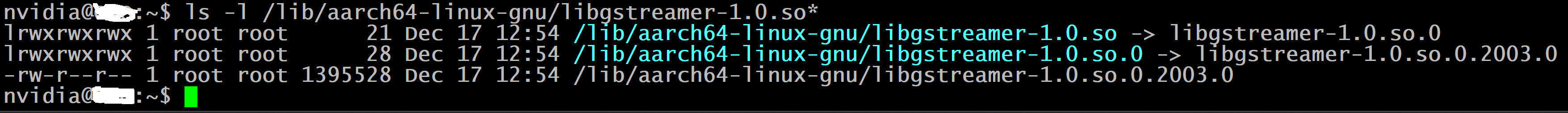

it’s important because I checked the runtime dependecies of it and discover that it depends on gstreamer
$ ldd /usr/lib/aarch64-linux-gnu/nvidia/libgstnvdsseimeta.so.1.0.0
linux-vdso.so.1 (0x0000ffffa111c000)
libgstreamer-1.0.so.0 => /lib/aarch64-linux-gnu/libgstreamer-1.0.so.0 (0x0000ffffa0f40000)
libglib-2.0.so.0 => /lib/aarch64-linux-gnu/libglib-2.0.so.0 (0x0000ffffa0df0000)
Relate to this I think I have to build libgstnvdsseimeta by my own to keep binary compatibility
