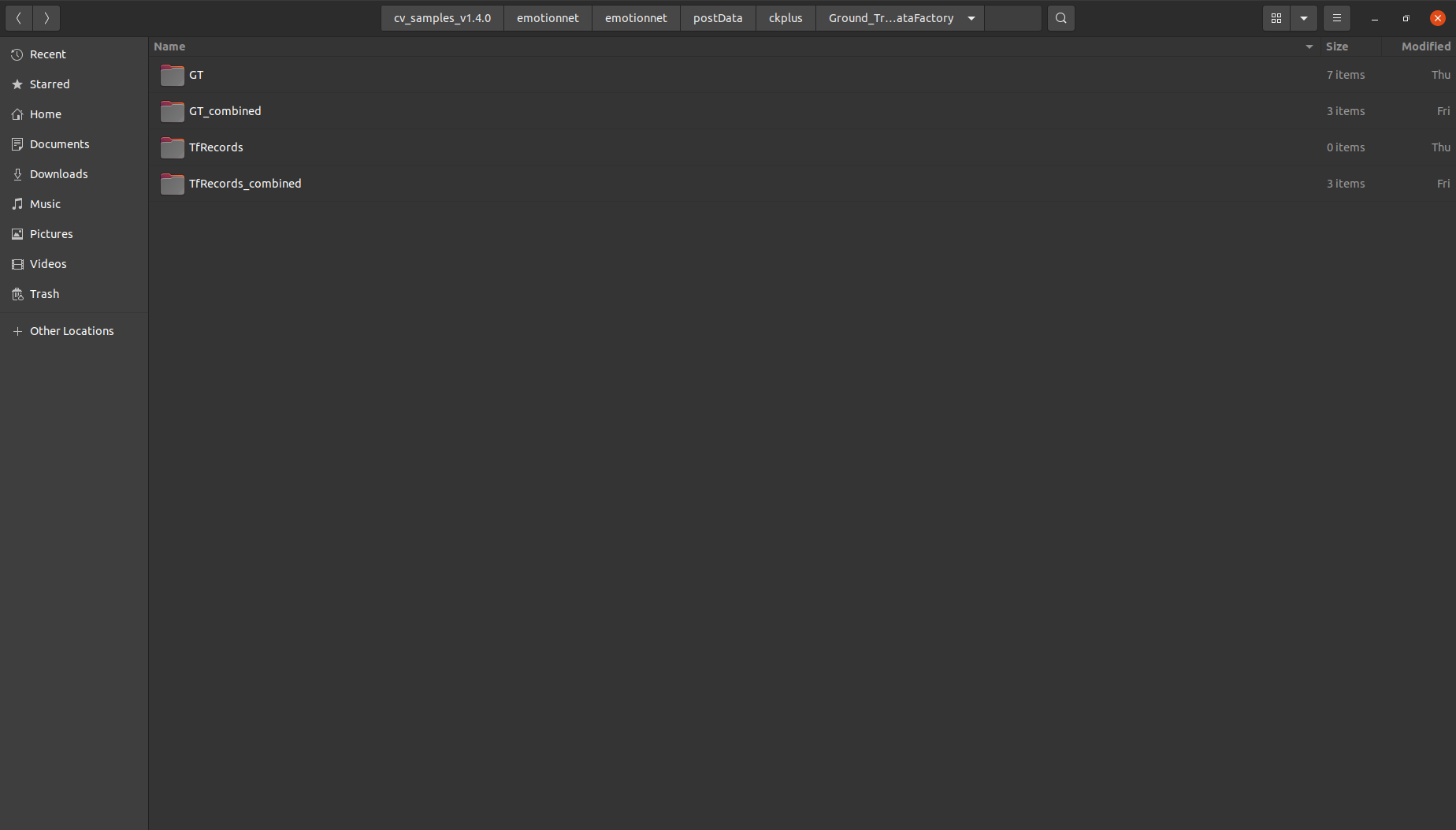

Did you ever run with the default Jupyter notebook and find teh tfrecords?
Yes, I should have mentioned that the training worked as expected (including the tfrecords) with the default notebook and the ckplus dataset. Now that I’ve brought in a new dataset, I’ve had to format it in a way that is similar to the ckplus dataset, but I was successfully able to do that and convert the data to json format.
I should also note that yesterday, I started receiving the following warning whenever I run a tao command:
/home/hipe/Facial_Recognition/lib/python3.7/site-packages/tlt/init.py:20: DeprecationWarning:
The nvidia-tlt package will be deprecated soon. Going forward please migrate to using the nvidia-tao package.
I’m aware that changes are actively happening as nvidia is transitioning away from tlt. The default notebook still uses the env KEY “nvidia-tlt” and seems to still rely on elements of the nvidia-tlt pacakge. But given that the original notebook still doesn’t have any issues, I’m not sure if the deprecation of tlt could explain why the tfrecords aren’t being populated.

It does appear to split the data, but this is unfortunately the old data from the ckplus dataset. It appears to still be configured for the old data and not the new data I’m giving to it.

As far as I can tell, all my local data paths are set up properly, as I’m not getting any errors in that regard, and also the tfrecord files are being created (albeit empty). Here’s a screenshot of what my Ground_Truth_DataFactory folder looks like, if that would be any help:
The “GT” folder contains 7 text files (one for each emotion), where each text file contains all the landmarks for each image within that emotion. Example:
Afraid.txt (57.3 KB)
The GT_combined folder contains “test.txt”, “train.txt”, and “validate.txt”, but all those are empty. I believe all this is supposed to be doing is splitting up the GT data, but clearly that part is not working. So it’s occurring to me that maybe the issue isn’t primarily with the tfrecords, but with the fact that it can’t parse the data in the GT text files. In the original dataset, there were far more text files with less data in them, whereas in mine, there are only 7, with much more data in each one, but the format should be the same. Can you see any possible reason why the GT_combined text files aren’t being populated with the data in GT?
I just realized that the fact that there are only 7 text files to parse may be the issue. In the original dataset, the way things were categorized resulted in way more text files. I assume the test/train/validate split is set up such that a certain percent goes into each category, but with only 7 text files, there may not be enough to do, say, a 10% test split. Could that be why the folders are empty?

I ran the command and obtained the json files. I actually went back and resorted the data to identically match the original ckplus dataset (i.e. under images, there’s a folder, then a subfolder that contains a single image file). Here’s an example json file:
002_disgust.json (4.6 KB)
I did a 1:1 comparison with those from the original dataset and they look identical in form. The way I have things configured now, I have approximately 400 json files - one for each image. When I run the dataset_convert command on them, the GT folder is populated with ~400 txt files, which appear to be formatted properly, but still the GT_combined and TfRecords_combined folders contain train/test/validate files that are unpopulated. I’ve checked everything (the data paths, the python conversion file, the config file, etc.) repeatedly and everything seems to check out. The json files, again, seem to look exactly how they should.
A couple considerations:
  1. Is there anything inside my dataio_config_ckplus.json file that appears incorrect? I’ve tried changing things in there but nothing has worked as far as I can tell. The only difference between it and the original is the emotion map is slightly different.
  2. Is there perhaps anything I need to change in the dataset_convert.py file to account for my data? I attempted to access it through the root folder in the nvidia docker, but am denied access to the root folder. Is there any way I can access that py file, or is that unnecessary?
  3. Does it matter that my image extension is JPG, not png?

  • Modify the tree and filename. Just strictly follow the “tree” and the filename inside the ckplus folder.
  • Modify ckplus_convert.py
    image_file_name = file_prefix + ‘.JPG’
I’ve made changes to the tree and filename without success. For now, I’ve decided to take a slightly different direction with my research, but I’ll let you know if I have any future questions regarding tao. Thanks so much for you help!
