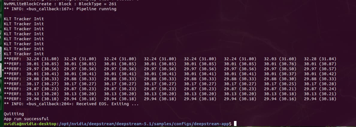

When I run the sample you provided, I get the following result:
Can you give an example of even displaying?
I am looking for a sample that works like the image below.
Thank you.
It should output same as the video. Do you check TV output?
I didn’t understand the question of checking the TV output.
Are you setting the TV output in the setting file?
Running the sample like this will output only text.
I ran it on jetson tx2.
Thank you.

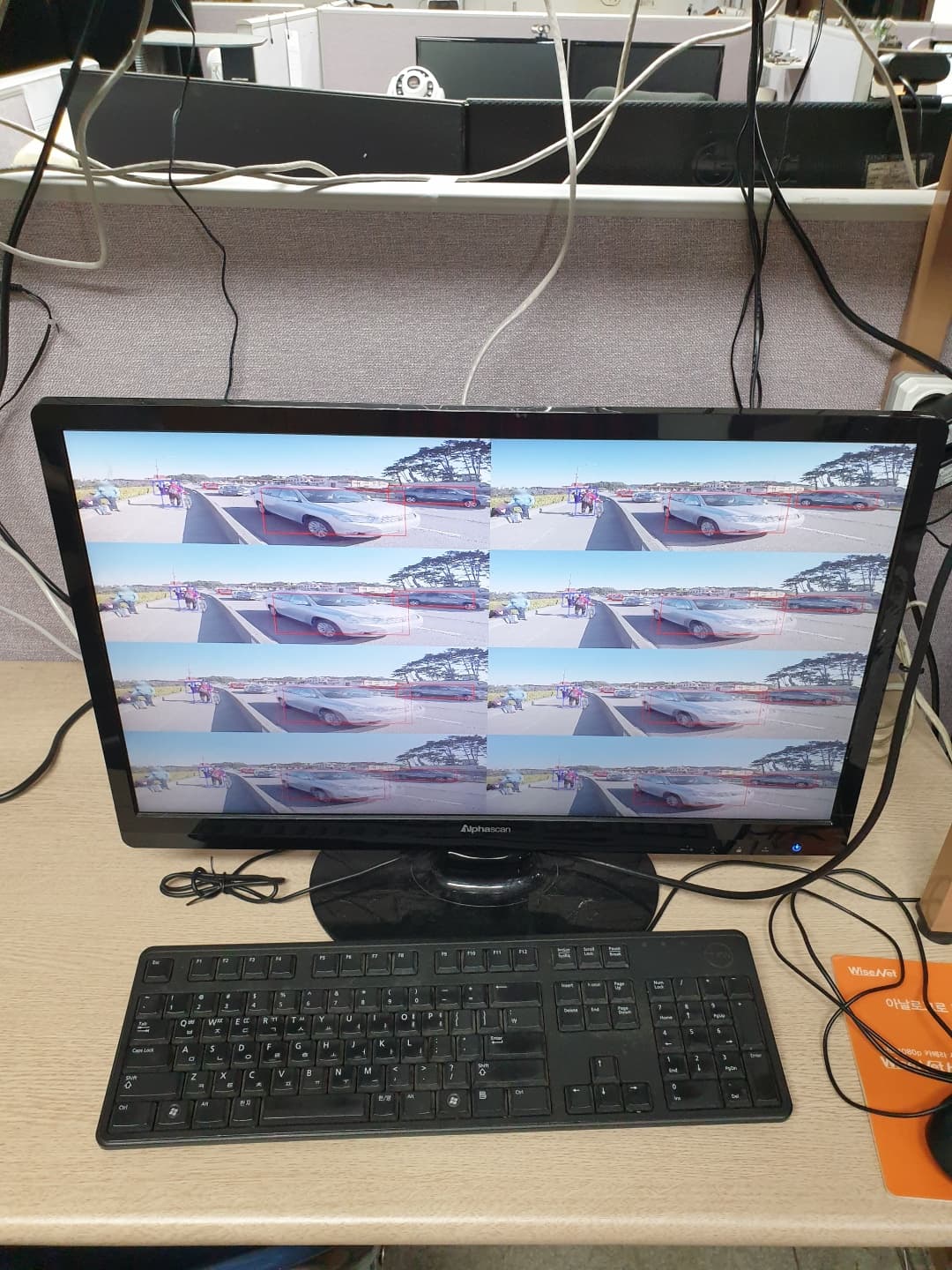

It has display output. Not only text. If you connect to a TV through HDMI, you will see the same output as the video.
Thank you very much.
