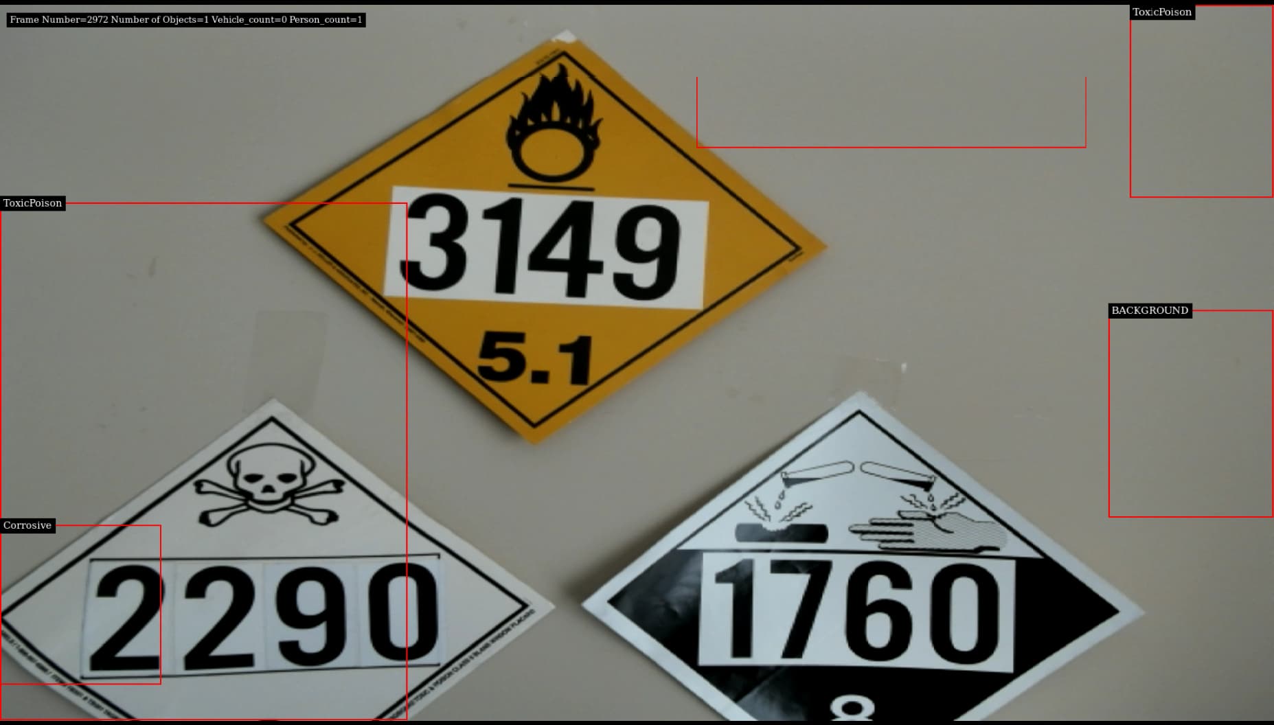

I’m still having an issue with the model loaded. The model loads however the detection’s do not appear to function in any usable capacity. I followed the pgie configuration from the link and I’ve tried adjusting detection threshold values and detection sizes but the output just appears to be noise.
Here is a screenshot of the model with jetson inference detectnet:
Hoping you can provide some guidance on the parameters that are required to be adjusted to optimize my models detection for deepstream.
Thanks again!
Could you check if the input pre-processing from jetson-inference and deepstream are identical first?
This is controlled by the net-scale-factor and offsets flag in the configuration file.
https://docs.nvidia.com/metropolis/deepstream/dev-guide/text/DS_plugin_gst-nvinfer.html#gst-nvinfer
y = net scale factor * (x-mean)
