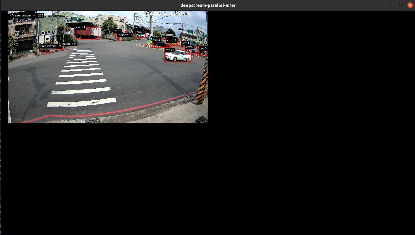

I have discovered an issue: when the RTSP reconnects after a disconnection, the model’s recognition disappears. Have you encountered the same problem?
original:
rtsp reconnect:
I modified the sample code to address the issue that caused the program to crash after an RTSP disconnection, achieving a successful reconnection. However, after reconnection, the object detection stops functioning.

During the execution process, I disconnected and reconnected the RTSP stream.
There’s nothing valid in the log file. Could you check the source_id, metadata in the probe function after the reconnection?
Okay, I’ll test it out again. Do you experience the same issue on your end?
The test results are as follows: Initially, both source_id and obj_meta->object_id print out normally. However, after reconnecting, while “Processing frame from source_id” still prints out the source_id correctly, the obj_meta->object_id does not print at all.

No. I cannot reproduce that on my side. Could you attach your changes for our demo? So I can try to reproduce that on my side. Thanks
I was able to use the RTSP reconnect function simply by adding rtsp-reconnect-interval-sec and rtsp-reconnect-attempts in the sources.csv file. When you say you can’t reproduce the issue, do you mean that you’re unable to trigger the reconnection, or that the object detection fails after reconnection?
I just set the rtsp-reconnect-interval-sec to 10 and rtsp-reconnect-attempts to -1 in the create_rtsp_src_bin function.
Since we don’t have an actual camera at crossroads, so we just use ffmpeg to create an virtual rtsp stream. But when I broke the virtual stream and re-created the stream, the demo couldn’t reconnect properly.
So we need your detailed operation steps and changes in our code to reproduce that on our side.
I was able to use the RTSP reconnect function by simply porting the bus_callback (GstBus * bus, GstMessage * message, gpointer data) from deepstream-app and adding rtsp-reconnect-interval-sec and rtsp-reconnect-attempts in the sources.csv file. I didn’t make any other significant changes.
I have tried that with 2 sources. After the reconnection, it works well. Below is the config file I used.
