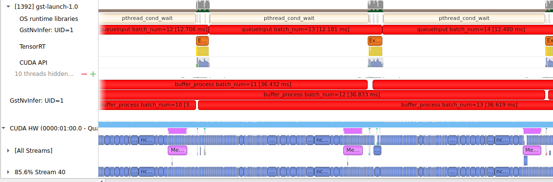

I inspected the pipeline with nsight. I noticed that between inference of batches, there is a delay of around 90ms. I assume this is caused by the dequeueOutputAndAttachMeta. I don’t see any GPU activity for that part, so I assume this is done on the CPU? If I change the network type to classification (just to see the difference), there is no delay between the inference of two batches.
Segmentation
Classification setting (same network)
I’m not sure yet what the postprocessing for the segmentation network contains, but it seems to be incredibly slow since I just want to do an argmax. Maybe it is better to just add this to my TensorRT engine, but I still want the output mask. So I guess I need to maintain the segmentation setting for the nvinfer plugin? Or should I change it to classification and attach the raw output tensor as meta data? This might be a good solution, but I don’t know if the “classification setting” can handle a 2D output map.
All processing you mentioned are open source. You can find them in /opt/nvidia/deepstream/deepstream/sources/libs/nvdsinfer in your device.
