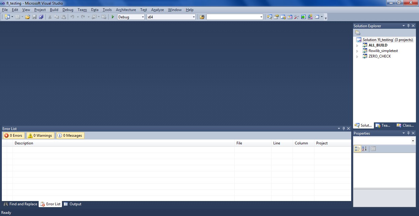

I’m running into some trouble with VS10 now.

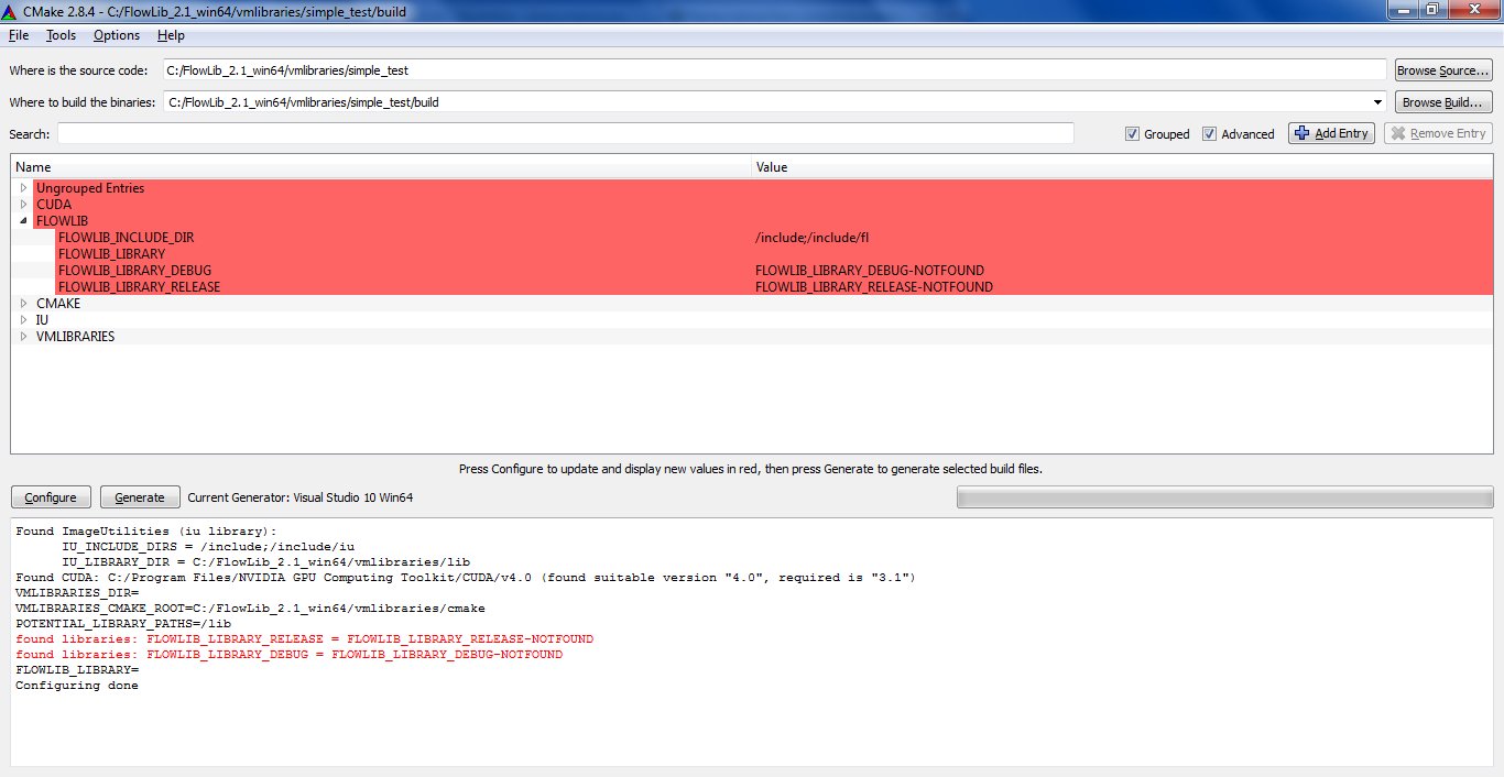

OK, when I configured and got the cuda_included_directories error, I manually set the IU_IUCORE_LIBRARY and IU_IUIO_LIBRARY to their location. As shown in the attached
Image1.jpg, there are a number of other libraries that are not found either, but I can’t manually point to them because they are not included in the /lib directory.
Anyway, at this point I hit configure again, and got a flowlib libraries not found message (as shown in Image2.jpg). So I manually set FLOWLIB_LIBRARY to /lib/flow.lib and hit configure again. The result is shown in Image3.jpg. It says “configuring done”, even though there are still a few non found libraries and got some warnings? in red. I hit now “generate” and just says “generating done”.
So I go to the build folder, and open flowlib_simpletest.vcxproj in VS10 (Image4.jpg). At this point I Build > Build solution and got a Cannot open ‘iu/iucore’ message in flowlib_simpletest.cpp, line 31. No matter if I chose the Debug, Release or any other configuration I still get the error. I guess the libraries were not correctly installed.

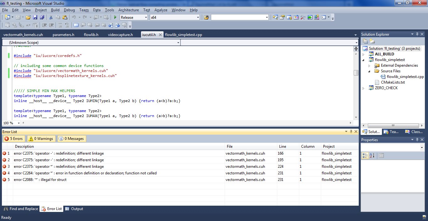

So, I manually copy the iu/ and fl/ to the same directory where simple_test it, and change #include <iu/iucore.h> with #include “iu/iucore.h”. But then it won’t find another includes in other files, like #include <iucore/coredefs.h> in coreutil.h, so I also put those between quotations and aadd iu/ in some. But then I get some redefinitions errors (Image5.jpg). At this point I have no idea how to continue.
Any ideas?
Anyone?
The redefintions come from Cuda 4.0 as those operators weren’t defined in Cuda 3.2 we had to define them. The library is coded for Cuda 3.2 and not 4.0. If you want it to use it with Cuda 4.0 try to delete the duplicated operators but I cannot guarantee anything.
