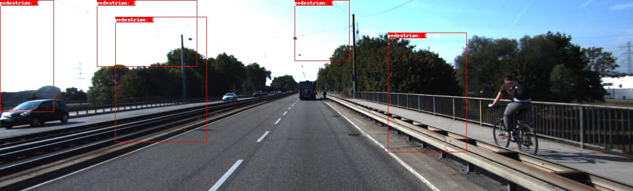

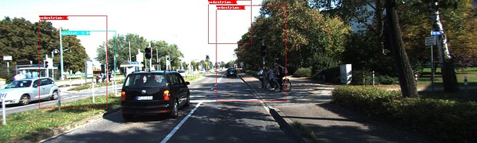

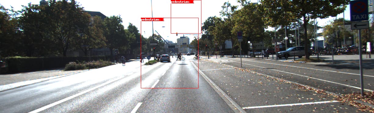

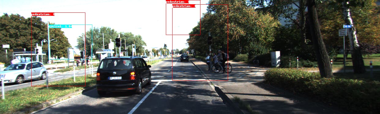

I am facing similar issue while testing on TRT engine. Here are the inference results obtained from TRT engine.
Also I am facing drop in accuracy after converting the model to ONNX.
  • Network Type : Detectnet_v2
  • TLT Version: v5.5.0
tao deploy detectnet_v2 gen_trt_engine -m /workspace/tao-experiments/detectnet_v2/export/tao_export_model.onnx --data_type fp32 --batches 10 --batch_size 4 --max_batch_size 64 --engine_file /workspace/tao-experiments/detectnet_v2/results_trt/resnet18_detector.trt.fp32 --cal_cache_file /workspace/tao-experiments/detectnet_v2/results_trt/calibration.bin -e /workspace/tao-experiments/detectnet_v2/specs/train_config.yaml --results_dir /workspace/tao-experiments/detectnet_v2/results_trt --verbose
tao deploy detectnet_v2 inference -e /workspace/tao-experiments/detectnet_v2/specs/detectnet_v2_inference_kitti_etlt.txt -m /workspace/tao-experiments/detectnet_v2/results_trt/resnet18_detector.trt.fp32 -r /workspace/tao-experiments/detectnet_v2/results_trt -i /workspace/tao-experiments/detectnet_v2/test_samples -b 4
