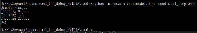

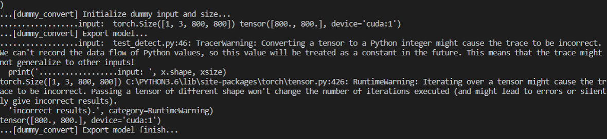

Log Success
Log test convert:
Log successfull simplify onnx:
Above I showed the successful case which can convert to onnx model without class part of Detectron2.
