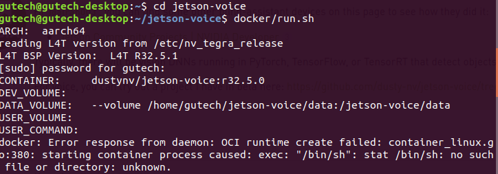

I downloaded the Jetson-Voice repos and tried to run the container but I ran into a problem (see the pics below). I also reported an Issue on Github for the same problem.
Are you aware of this issue when running the jetson-voice docker container? is it from my end or the container is down ?
Thanks again in advance for your response.
