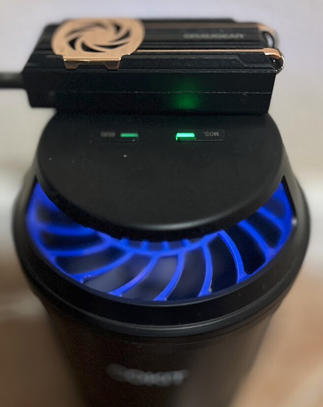

So I came to the conclusion that what @maiia is trying to do using the external fans might be the only way, but go a step further. Have a brilliantly elegant way to manage the heat from USB enclosure that complements this beautiful DGX Spark’s design.
That’s an indoor bug trap in case anyone wondering. Killing two birds with… two bugs??, yea whatever. So far after hours being up and few GBs being copied, and it HASN’T fall down from the grace to <40MB/s hell.
  • GRAUGEAR USB 4.0 PCIe Gen4x4 40Gbps: they have two versions: one with JHL 7440 and another ASM2464. Guess what I got.
  • Crucial T500 1TB PCIe Gen4 NVMe M.2 SSD. I chose this over WD_BLACK and Samsungbecause of its cache helps in AI use-cases compared to gaming. In short, few big file copy vs lots of small files. Also 1TB generates less heat than bigger ones and I figured I will not have to deal with files larger than 100GB most of time. So instead of paying for 2TB one, just get few 1TBs with other cases.
  • Indoor Insect Trap with quite (relatively speaking) fan.
BEST PART: You might get a whip of smell, see a tiny smoke, or even occasionally hear a scream of a little bug. You are welcome! I know, It’s a perfect revenge for all that itches from their bites while keeping your precious NVMe cool.
