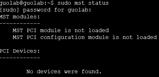

I have bought several CX3-pro cards. I’m now not able to use RDMA in my guest Ubuntu VM.
I’m wondering whether this card supports guest RDMA or I’m making some mistakes in configuration?
My detailed configuration is as follows:
Host Configuration: Windows server 2019 on Dell R720XD, WinOF driver 5.50.42, NIC firmware 2.42.5000. RDMA and sriov both enabled in BIOS, NIC, and HyperV swith and VM.
Guest Configuration: Ubuntu 16.04 in Hyper-V. Driver “MLNX_OFED_LINUX-4.5-1.0.1.0-ubuntu16.04-x86_64”.
In my guest Ubuntu VM, I can see the Mellanox NIC VF through lspci
and ibv_devinfo reports fine
but mst status reports there is no device found
CatchE150(04-19-16-08-20)
and ib_send_bw also fails
Catch51D5(04-19-16-08-20)
if you approach to our Mellanox WinOF Release-Note v5.50, https://docs.mellanox.com/display/WINOFv55052000/Release+Notes+Rev+5.50.52000
There you can find that within Windows 2019 Host- “Any supported guest OS for Hyper-V”, including Ubuntu 16.04 , is supported only in Virtualization Mode of VMQ, meaning: it is on the top on vmSwitch with no RDMA capabilities!!
The only guests (VMs) that WinOF v5.50 supports with RDMA capabilities are Windows-2016/2019 OS
In other words - I’m afarid you cannot use guest RDMA in your Ubuntu 16.04 VM, for the resouns I mentioned above
