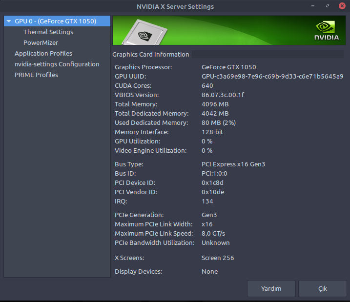

As a last note , ( not sure if it makes any difference or sense ) but a screenshot from NV x-server settings. I wonder why it says X Screens:Screen 256 and Display Devices:None
