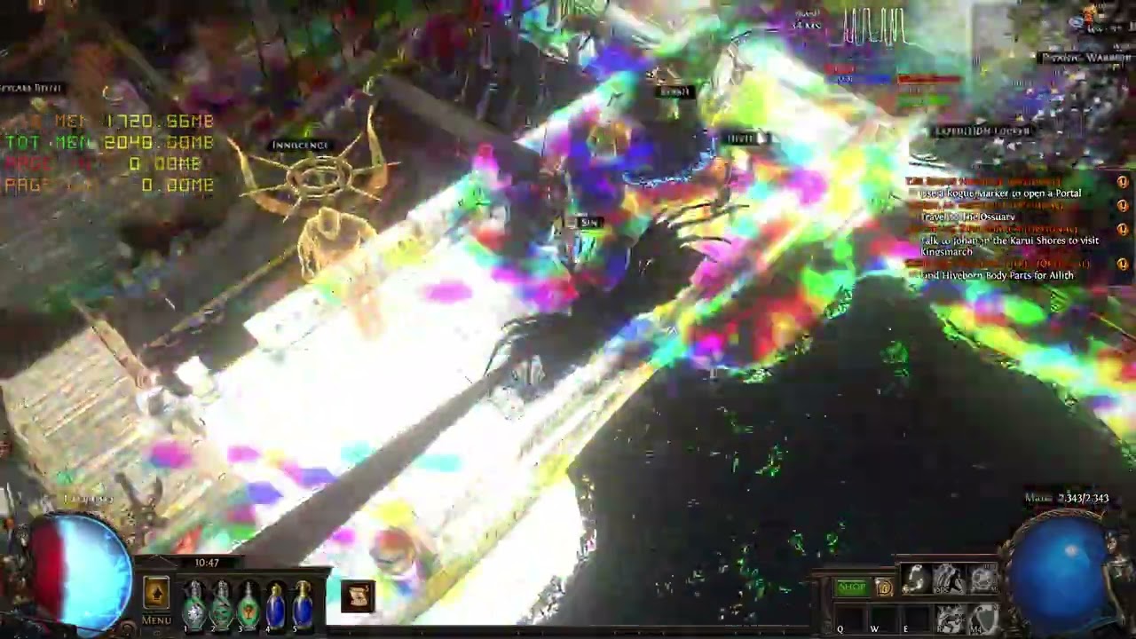

The issue manifests as severe visual glitches, but not artifacts, meaning the GPU itself is not physically faulty.
The card continues to function normally under all other conditions.
The glitches occur at certain moments when, in my opinion, the driver hangs and fails to recover properly, causing visible corruption on screen.

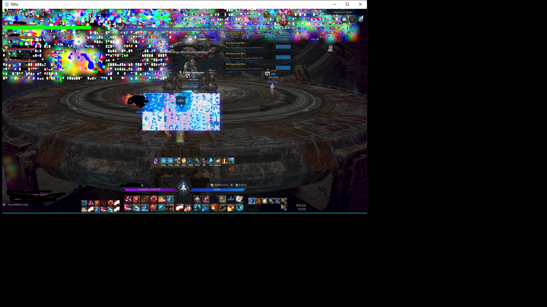

When this issue occurs while a Vulkan-based game is running — either natively or through DXVK — the same type of glitches appear in Chrome.
In Chrome, these appear as black and gray squares that disappear once the UI refreshes or when I move the mouse.
While less severe than in games, this happens frequently whenever a Vulkan application is active.

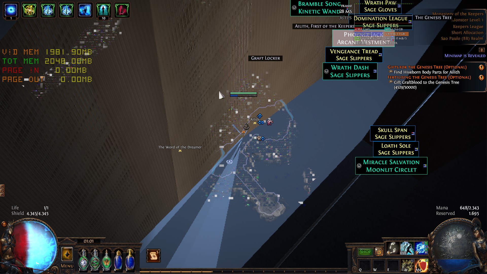

At first, I thought it might be caused by the graphics card running out of VRAM.
That seemed plausible because VRAM usage often approaches the maximum right before the issue occurs.
However, I have ruled that out — the problem also happens when using less than half of the available VRAM.
In any case, running out of VRAM should not normally cause this kind of corruption or trigger a “device lost” state.

The in-game effects include:
  • Textures glitching or stretching infinitely
  • Flashing or fluorescent colors (pink, green, purple, yellow, blue, red)

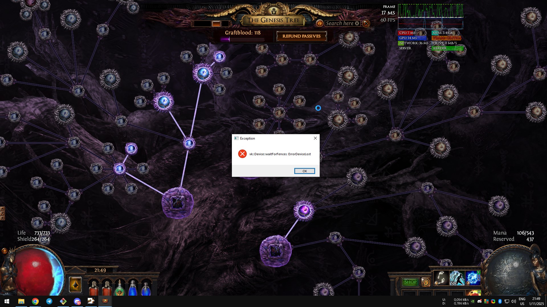

  • Eventually, Vulkan crashes with a message like “Device Lost”
After that, the game becomes unplayable until it’s restarted.

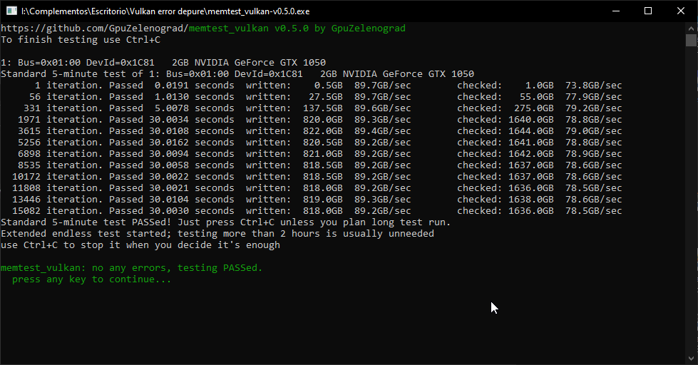

  • Ran GPU stress tests using DirectX (no crashes or instability detected)
  • Reapplied high-quality thermal paste and cleaned the GPU
  • Inspected the GPU physically — no damage or overheating found
Despite all these efforts, the issue only occurs when using Vulkan, regardless of driver version or hardware configuration.

For those curious, here’s a video forcing the bug/error/glitch:
I’ll reiterate that this bug happens to me in any game using Vulkan.
