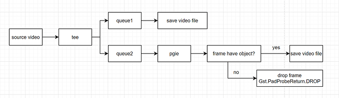

I want to develop a feature in my project like this. This is a mp4/rtsp input and I need to save the full origin video and the other is to infer the frame ,judge whether the frame has object and save frame or drop frame.

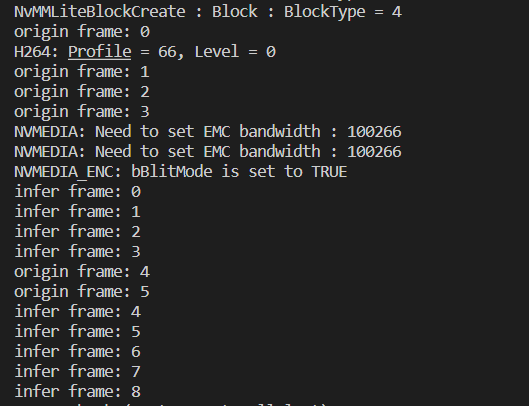

Now I add probe after infer and do something like this, but my program hang after 8 frame .So is there some example to resolve my problem?
In your output image, what is origin frame? the actual frame?
Infer frame means that it had atleast one object?
May I ask you to share the snippet of your probe function (not entire code) so that I can understand why it would stop after 8 frames.
I cannot really tell by looking at an if statement and this output log.
The origin frame is the probe after queue1 I write to find problem

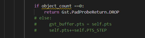

The infer frame is the probe after pgie and following is my drop frame code
def osd_sink_pad_buffer_probe(self,pad,info,u_data):
        gst_buffer = info.get_buffer()
        batch_meta = pyds.gst_buffer_get_nvds_batch_meta(hash(gst_buffer))
        l_frame = batch_meta.frame_meta_list
        while l_frame is not None:
            try:
                frame_meta = pyds.NvDsFrameMeta.cast(l_frame.data)
            except StopIteration:
                break
            frame_number=frame_meta.frame_num
            print("infer frame:",frame_number)
            l_obj=frame_meta.obj_meta_list
            frame_object_count = 0
            while l_obj is not None:
                try:
                    obj_meta=pyds.NvDsObjectMeta.cast(l_obj.data)
                    break
                if obj_meta.class_id == 1:
                    frame_object_count +=1
                try:
                    l_obj=l_obj.next
                    break
            if frame_object_count ==0:
                return Gst.PadProbeReturn.DROP
            try:
                l_frame=l_frame.next
                break
        return Gst.PadProbeReturn.OK
Ah, so basically you are probably saving the images as a video using filesink then?
You are trying to use Gst.PadProbeReturn.DROP with the intention of skipping this frame thus it won’t be passed onto the filesink or am I mistaken in my understanding?
If this is the case, I have not tried this method tbh, I did have a similar situation in my case so I chose to do it in different ways. (Yes for different situation, I had to save videos in different ways)
Can I ask something, do you have to use filesink if you are using it?
yes, I’m using nvv4l2h264enc and filesink to save video in both queue1 and queue2 .
It works well if I only have queue2 this pipeline , nothing go wrong . But after add queue1 this pipeline to save origin full frame video. The program stop after 8frame look like some data hang and I dont know why
ah, so the usage of tee and queues is the problem.
have you tried to use nvvidconv or nvvideoconvert before filesink in queue1?
also, what does the output log show when you use GST_DEBUG?
Of course I have pige → nvvideoconvert → capsfilter → nvv4l2h264enc → h264parse → qtmux → filesink
GST_DEBUG show nothing and I think the problem is Gst.PadProbeReturn.DROP cause something I dont know . If I delete return Gst.PadProbeReturn.DROP It can work but I want to drop frame because I need to do this feature
