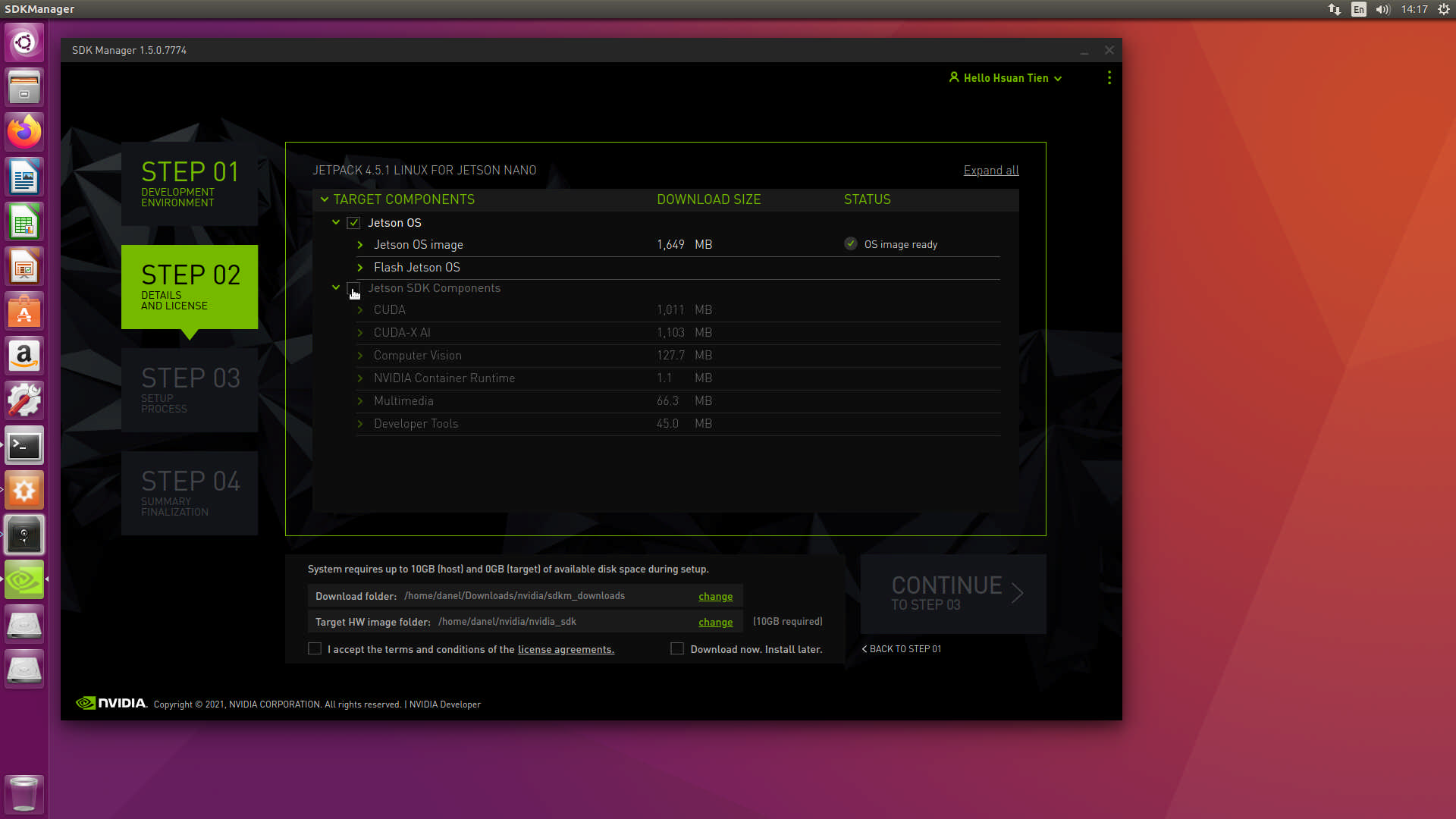

Thanks, but how to do this?
  1. Install system image through SDKManager. Not to install SDK Components.
There is no way to install w/o SDK components, you can’t uncheck this.
Please check
Ah… sh… yes. On the second page. Will try and let you know
OK, I can confirm this to work.
