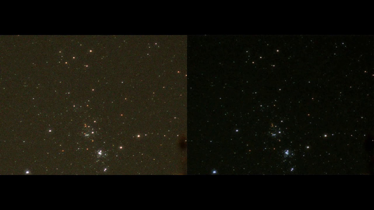

An other example with a cleaner result.
This time, exposure time is longer and camera gain is much smaller. IMX178 sensor is rather good but its photosites are very small (2.4µm) and rising gain generate heavy noise.
External Media
Real time treatments bring many informations that were hidden if the non treated image.

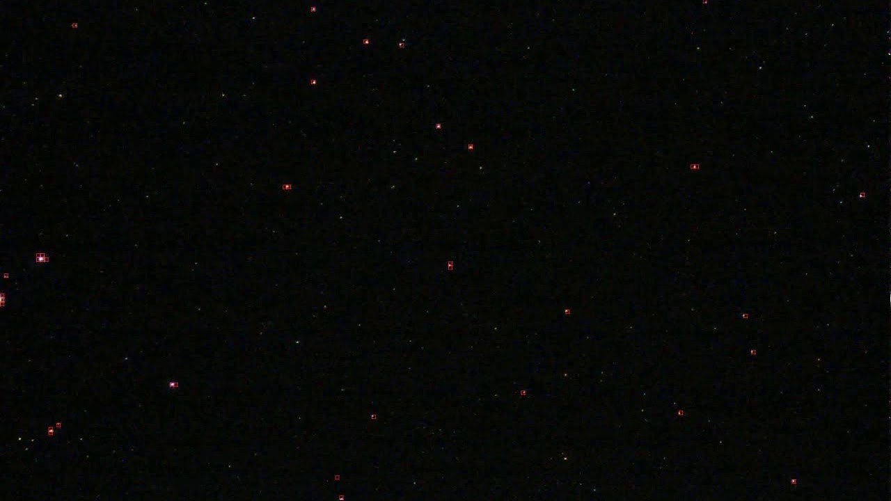

still working on my automatic stars ans satellites detection routine.
Applying a threshold filter to try to get bright stars or satellites is interesting (but not that much easy to make because raw video may be very noisy with bad quality) but you will get informations in the image and that kind of information can’t be use to calculate something if you do not go further.
To be able to make some calculations, you will have to find coordinates of the objects (and other things like relative size, form factor etc.). This means i have to find objects in my images.
Here is a video showing different kind of treatments.
Upper left : the raw video
Upper right : the raw video with the threshold result (but no X,Y coordinates !)
Lower left : the treated video (cleaned images) with this time the objects detection (circles with X,Y coordinates and size) ; this time i can make calculations with the objects !
Lower right : the raw video with the detected objects.
I still need to work to get robust routine but i am quite happy with the result.
Post treatment was made using Nvidia #JetsonNano with Python, PyCuda, numpy and OpenCV. I did not use some AI routines to create my routine.
Well, that’s all for now. I am very happy with the result. Maybe someone could think that kind of work does not need heavy routines but in fact, i had to apply many filters (clean image, enhance bright dots, remove background gradient, remove noise, apply appropriate threshold, collect objects, find size, remove artefacts etc.)… Quite many work in fact.
The video resolution is 1544x1040 pixels (that is to say about 1.5 Mp). I must say Jetson Nano can manage it (as sky survey video means long exposure time most of time) but it starts to be a bit weak. Anyway, he can make the job.
Alain

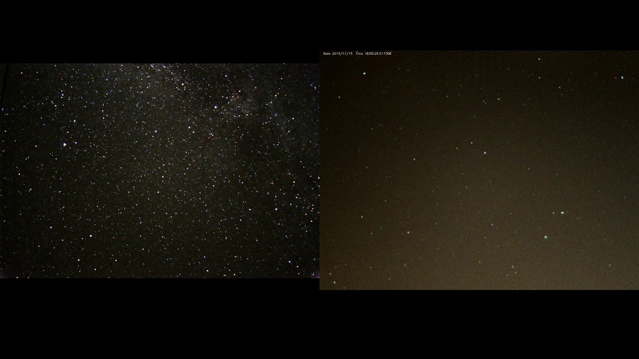

an interesting video showing impact of light pollution on sky survey video.
The setup is the same for the 2 videos (Jetson Nano, IMX178 colour sensor, CCTV 8.5mm f/d 1.5 lens) but :
  • the left video was taken in french Hautes Pyrénées (mountains area)
  • the right video was taken near Dijon (France) that is to say city light pollution
Light pollution is really hard to manage.
We can use optical filters but we loose important part of sky signal.
Software treatments can bring things but it is not magical at all. Captures conditions for the sensor are a bit extreme and it is really hard to get very good real time software treatments with sky survey. Tiny sky signal is really killed by light pollution. Best software treatment can’t find information when you have lost it.
Depending of the sky, we have to find the best acquisition system (lens, camera sensor, software). Some solutions will work with specific conditions, some won’t.
It would be really interesting if Nvidia could collaborate with a sensor builder (like Sony ?) to try to improve sensor treatments in particular difficult conditions.
Alain
Just an idea on light pollution. If you do the reverse of finding the points in the image which are considered bright enough to be of interest, and instead use AI to find the darkest points which are between points of interest (and interpolation between dark points), perhaps then you would have a map of estimated light pollution. Subtracting that out would leave you with a less polluted image (presumably everything would be darkened by exactly the amount of light pollution).
I know, if sensor hardware had this directly built in it would be superior, but once you have CUDA to work with there isn’t much cost to having AI learn to find darkest points between points of actual light.
Hello linuxdev,
if i understand well, you say i have to remove back ground light pollution and keep brightest stars.
I already did that with a gradient remover filter. I subtract gradient information to the image. It works quite well (i have to improve my filter).
In the light polluted video, i have already subtract the gradient (most of it). The test capture without gradient removal is horrible (bright white/orange sky).
The treated video is good enough to see satellites, planes, meteors etc. but the small stars and deep sky objects are drowned in the gradient and it is impossible to retrieve the signal with software solution.
I can use astronomy filters which are suppose to remove light pollution (like UHC, UHC-S and CLS filters). In that case, filters remove sodium wavelength for example and light pollution is much lower but i loose a lot of signal. I have to raise sensor gain very high and increase acquisition time and i get very very noisy image.
If sky is bad, the sensor is the key point. For now, my camera is not good enough and i would need a new sensor. Unfortunately, a good camera is about 900-1200$ and i have to find the money to buy one.
Maybe one day.
Alain
