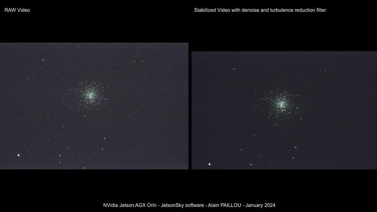

An example of image stabilization with turbulence & noise treatment, using JetsonSky :

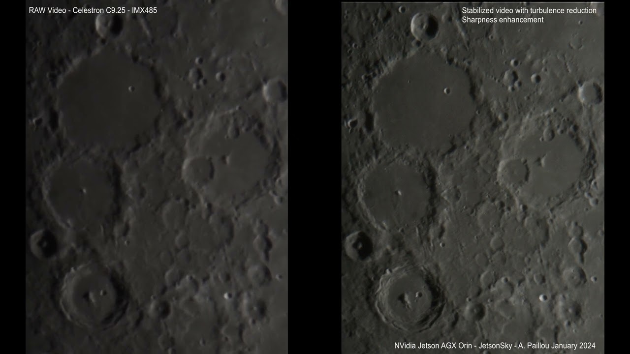

yesterday, the sky was pretty good so i decided to use my Celestron C9.25 to make tests with the Moon and Orion Nebula M42.
First, the Moon.
The C9.25 was at F/D 16, that is to say the focal was 3760mm. The camera uses an IMX485 colour sensor.
I used JetsonSky with post treatment :
  • image stabilization
  • noise and turbulence management
  • sharpness enhancement
Then, i applied classical treatment (Autostakkert 3 and Registax 6).
The result :
For a colour camera (with bayer matrix), the result is very good. Quite near a monochrome camera.

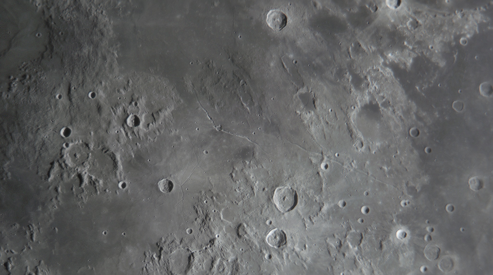

from my last captures, with post treatment with JetsonSky : colours of the Moon’s soils (4K video) :
That’s all.

i worked a bit with my M42 video to try to get a better result :
As it was a test to see what parts of JetsonSky needs improvements, the result is not bad and it could have better if M42 was higher in the sky, if the Moon was somewhere else and if you would get a better setup of the mount.
I hope other tests will get better conditions. If the conditions are good for deep sky video, i think i can get the final result during live capture with a single pass treatment.

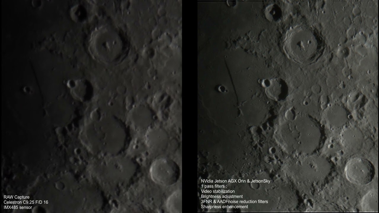

an other example of video enhancement with JetsonSky.
I wrote an other filter to manage camera noise. It’s called 3 frames noise removal filter. It uses N-2, N-1 and N filter to manage the noise and i must say it works quite fine. It can be used with other noise removal filters like AADF. That is to say i can use several noise removal filters in a single pass. It useful to manage noise AND atmospheric turbulence.
An example here :
I apply several filters in a single pass. The main goals are :
  • get a static image
  • remove the noise
  • apply sharpen filter
If the video is not clean you won’t be able to sharpen it.
The improvement is terrific, in my opinion for sure.
Alain
