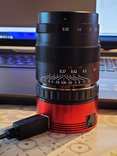

i have received a new lens : 7Artisans 35mm F0.95 lens with Sony E mount adapter.
As usual, when you receive new equipment, the weather is bad. Quite normal.
Here is the beast :
Alain

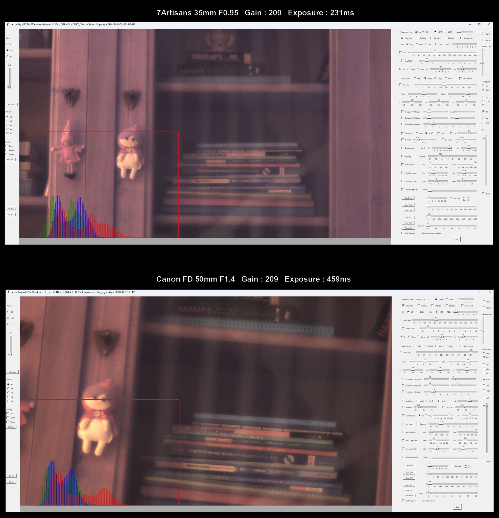

A small comparison between my new 7Artisans 35mm F0.95 lens and my old Canon FD 50mm F1.4 lens :
From F1.4 to F0.95 allows exposure time to be divided by a factor 2.
If i do not want to low exposure time, i will get lower gain, meaning lower noise.
Depending of my target, lower exposure time or lower gain are really interesting. It’s quite cool.
PS : i will release a new JetsonSky version in a minute because i had a dirty bug with pictures capture in the V41_01RC version. New version will be V41_02RC. Sorry for that.
Alain

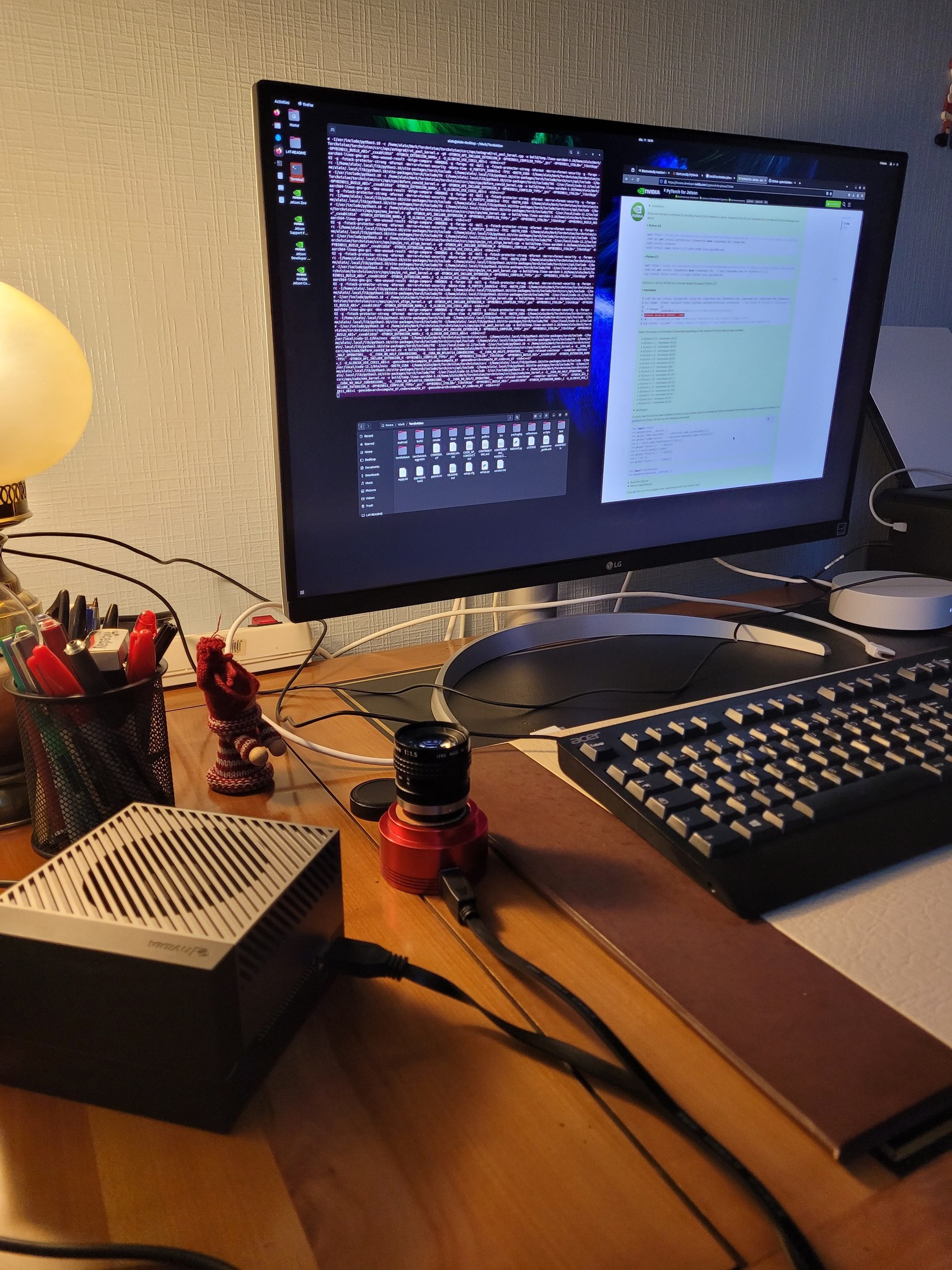

today, some heavy work to install JetPack 6.0 DP with the Jetson AGX Orin !
So :
  • Jetpack 6 is OK and it works fine
  • software environment for JetsonSky is OK (Cupy, etc.)
  • Pytorch 2.2 is installed and is OK
  • i have downloaded and compiled TorchVision 0.17.0 : it’s OK
AGX Orin compiling TorchVision :
That’s great.
Alain
As JP 6.0 comes with OpenCV without CUDA, i had to compile OpenCV.
The AGX Orin working :
i uses @mdegans script to compile OpenCV but i had to make some small changes in the script :

Select the OpenCV version you want to use. I selected this one :
DEFAULT_VERSION=4.8.0
libavresample-dev must be replaced with libswresample-dev
libdc1394-22-dev must be replaced with libdc1394-dev
You will have to select the appropriate Cuda architecture. For Orin, it is 8.7. Select the good architecture for you Jetson
I had to disable OPENCV_DNN_CUDA flag because i had an error when compiling with it. I don’t know why.
I am not sure of the CUDNN_VERSION (i uses 8.9.4).
Now, JetsonSky works fine with OpenCV & Cuda.
That’s all.

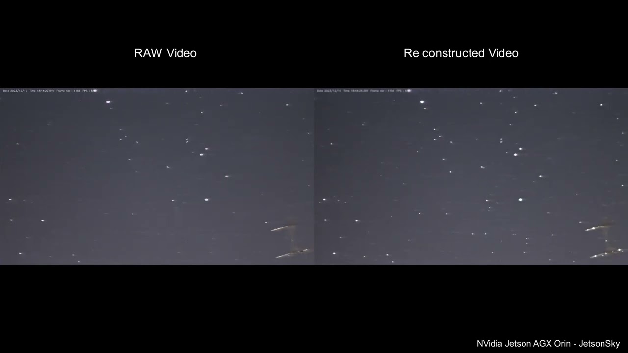

As @Honey_Patouceul suggested to me, satellites could be removed from the video.
Here is a first try. Not really good but not really bad.
Alain
I suppose you might need a better angular resolution, but it seems like the satellite removal could be tuned to also detect the wobble of stars. It’s all change, although a different characteristic. The reason I thought of that is the antenna (UHF television?). The antenna probably has a pendulum movement from wind and perhaps trucks driving by vibrating it. It has a resonant frequency. It would be cool if the movement filter could be generalized to different kinds of resonance.
Hi linuxdev,
i would in that case effectively a better angular resolution ! Interesting but a bit hard to realize.
I tried something more easy. As i am on holidays and sick (damned !), i get some time to make useless things with JetsonSky.
The exercise is to reconstruct the image considering the stars and satellites detection. I tried to preserve stars color, brightness and size ;
I guess it works. Not spectacular but the images are reconstructed !
Now i will have a little rest because i got cold and a bit tired.
Alain
