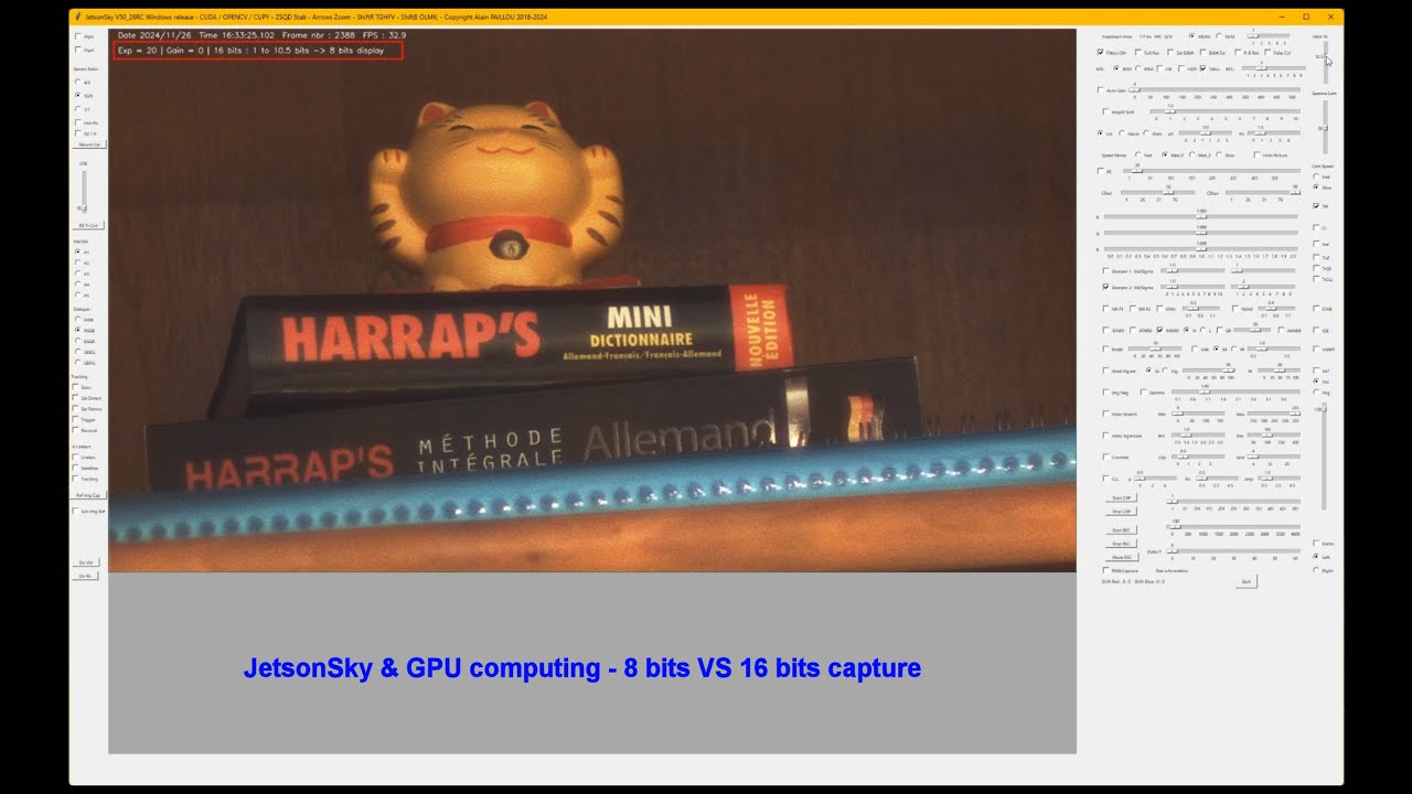

a daylight test to see 8 bits VS 16 bits captures :
Alain

i try to improve 16bits videos support with JetsonSky.
Astronomy software often use SER file format, which is a kind of AVI uncompressed format with a specific header. The big deal with SER files is that they can easily support 16bits data we can create with classical astronomy software like Firecapture and Sharpcap (they can capture a 16 bits video from a camera and save a 16 bits SER file).
So, i decided to add SER file support in JetsonSky (read only, i will always save 8 bits videos). It works. JetsonSky can now read 16 bits videos (monochrome or color) and choose which bits will be use to work with.
The fact i can choose the bits i keep to work with is really interesting to retrieve some very small signal. I can also make HDR capture with only one image because i can create from this unique image 3 or 4 images :
