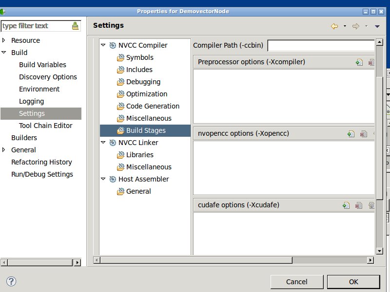

I am not entirely sure if you mean Nsight EE. In Nsight EE you can setup additional compiler flags as follows:
  1. Open project properties, select Build/Settings in the left-hand tree.
  2. On the Tool Settings tab, select "NVCC Compiler"/"Build Stages"
What I have is this: see attachment.
Now select NVCC Compiler/Build Stages.
Note that it might be this option is not compatible with the NVCC.
Ok,
This is what I’ve got.
Note that NVCC does not have -std flag. You can try adding the flag to “Preprocessor flags” group but it may break the way NVCC works.

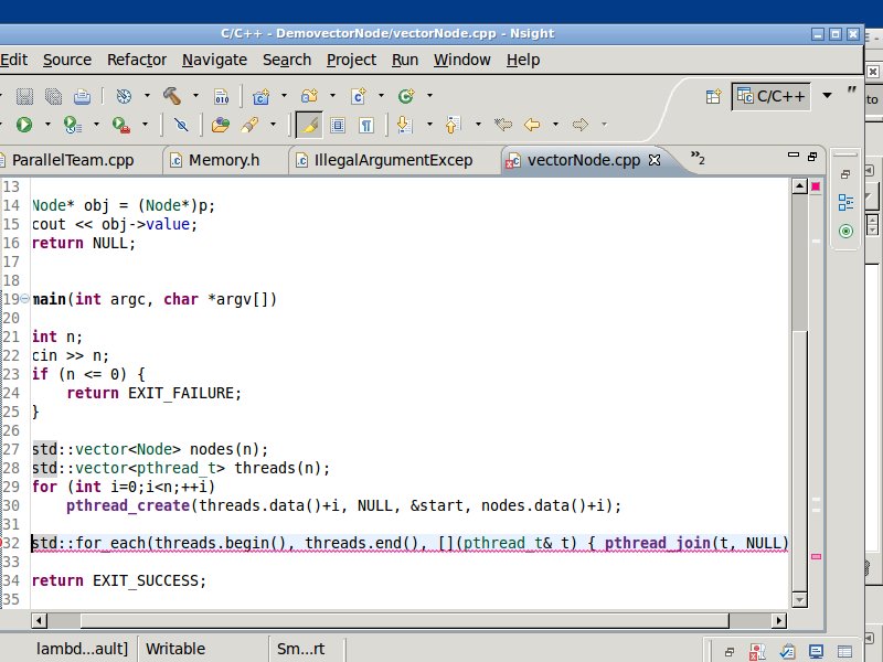

You say that nvcc doesn’t have the -std flag; so, how would I build/compile code that user the “pthread” library such as, “pthread_create” that use lambda expressions: see attachment.
I would suggest avoiding using lambdas in CUDA C code.
Could you suggest a workaround using pthreads?
Lambda is just a compact syntax for defining a function object. You can replace it with a function pointer or function object. E.g.:

Your “myfunction” would call the pthread_join with a thread and NULL.
If you don’t like creating a new function, regular for may be compact enough:
for (vector<int>::iterator i = v.begin(); i != v.end(); i++) {
    myfunction(*i);
