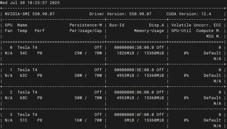

I run cmd in another machine(T4) , that is ok.
 gst-launch-1.0 videotestsrc ! nvvideoconvert ! nvv4l2h264enc ! fakesink
Pipeline is PREROLLING ...
Redistribute latency...
Pipeline is PREROLLED ...
New clock: GstSystemClock
^Chandling interrupt.
Interrupt: Stopping pipeline ...
Execution ended after 0:00:02.957495903
Setting pipeline to NULL ...
Freeing pipeline ...
How I solve this problem?
A100 does not have hardware encoder inside. Video Encode and Decode GPU Support Matrix | NVIDIA Developer, nvv4l2h264enc is a hardware video encoder.
