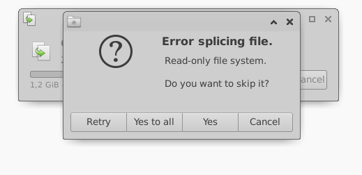

Recently I have a Jetson Xavier NX devit version with the jetpack 5.1. I reflashed it and I also has an exrternal SSD card with EXT4 format(The brand is SAMSUNG). Since I have to copy about 200GB data (ROS bag) from Jeston xavier nx to external SSD card, I noticed that when i finished copying 2 rosbags, the external SSD card became ready-only system. I did not have the authority to do any processing in this SSD card. Like the image shown below:

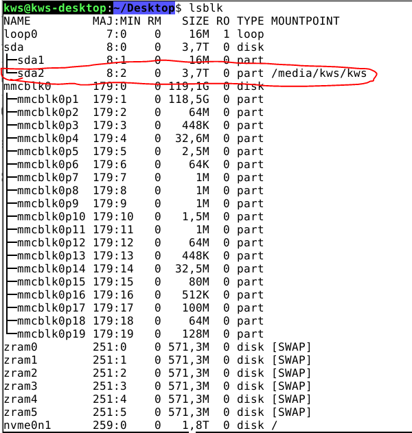

The result of the lsblk is shown below:

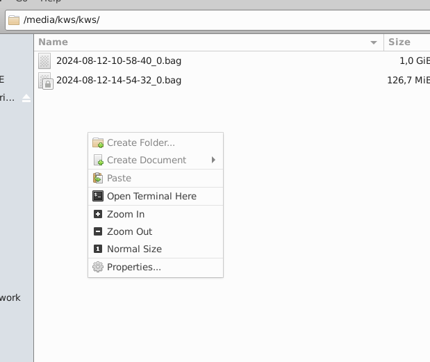

Here is before copying data to my SSD card. I can still do some operation in this external SSD card. But when I copy some big data then I got the error:
and in the lsblk:
When I unmount it I noticed:
Do you have any idea for it?
