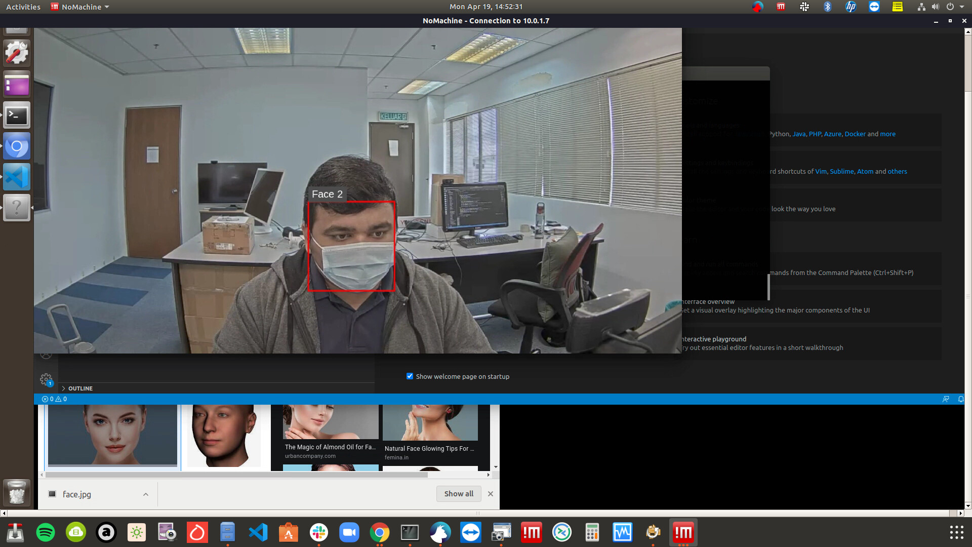

I usually run the file using the command;
deepstream-app -c deepstream_app_source1_facedetectir.txt
This is the output where face is detected.:
Also while running this I see a warning in the console that INT8 not supported trying FP16.
I want to run the same file with the custom model that I trained in any format INT8 or FP16 where the cell below is the only command mentioned in the ipynb for converting. There is no exporting step.

Hey @Morganh ,
Got the custom trained model working by following the steps mentioned above.
Thanks for your support on this post.
