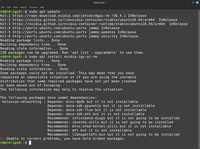

Fail to Install the NVIDIA AI Stack on IGX-SW v1.1.1
Recently, I install a new IGX-SW product release v1.1.1 with a RTX A6000.
I am fail to install nvidia-igx-ai-rm and apt show have unmet dependencies.
Do I need to manually install additional MLNX and DOCA packages?
Because there already has some MLNX kernel packages from IGX-SW v1.1.1 iso.
BR,
David
Hi david,
Are you using IGX developer kit or board kit?
How did you install IGX-SW v1.1.1?
Do you install it with dGPU stack?
Have you finished Update the Connect-X 7 (CX7) Firmware before install NVIDIA AI stack?
Hi Kevin,
I reinstalled IGX-SW v1.1.1 and the AI stack today, and the previous issue did not occur.
BR,
David
