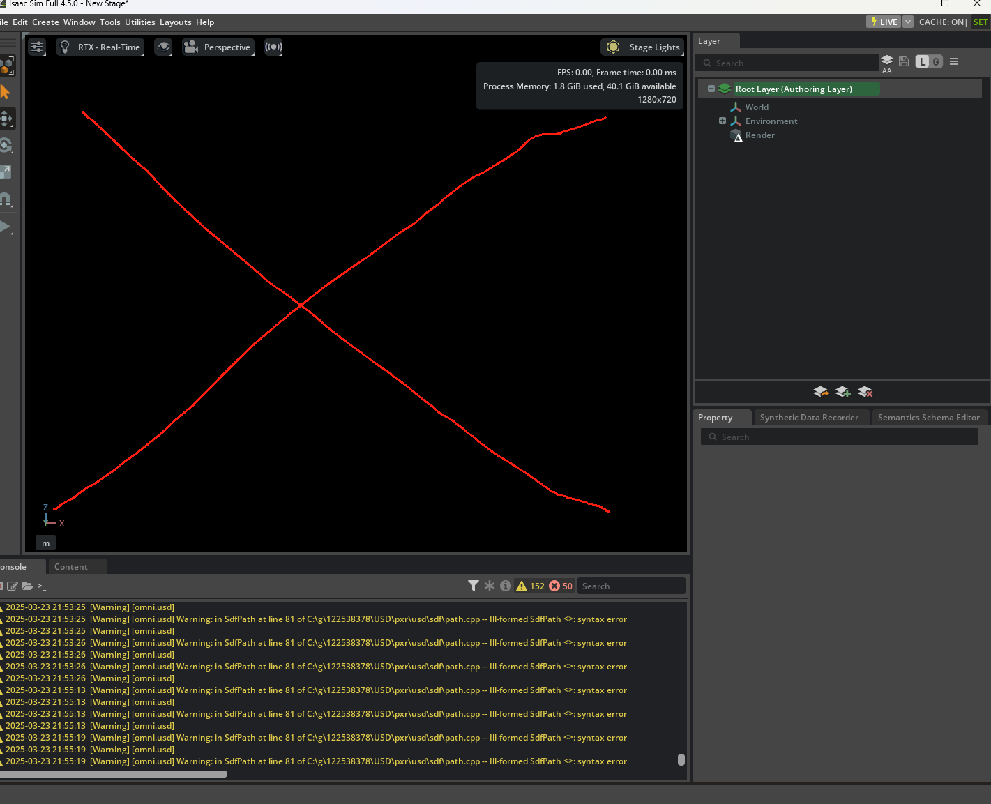

Even the app run, but the scene window keep dark and nothing showed
any creations or editions do not show at scene windows

2025-03-23 22:02:23 [12,077ms] [Error] [rtx.neuraylib.plugin] [MDLC:COMPILER] 1.0 MDLC comp error: C120 could not find module ‘::Z73file_3A::Z17D_3A::Z33program_2520files::Z72isaac_2520sim::kit::mdl::core::Base::OmniPBR’ in module path
2025-03-23 22:02:24 [13,624ms] [Error] [rtx.neuraylib.plugin] [MDLC:COMPILER] 1.0 MDLC comp error: C120 could not find module ‘::Default’ in module path
2025-03-23 22:02:24 [13,626ms] [Error] [rtx.neuraylib.plugin] Failed to resolve overloads. The MdlModule ‘mdl::Default’ is not loaded.
2025-03-23 22:02:24 [13,626ms] [Error] [carb.scenerenderer-rtx.plugin] Failed to uniquely resolve MDL material ‘Default’ from module ‘Default.mdl’.

run clear_caches.bat and post_install.bat before isaac-sim.bat

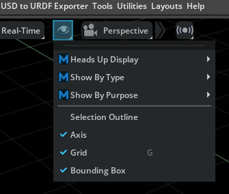

clik the eye icon
Are you following the instructions at Workstation Installation — Isaac Sim Documentation to run Isaac Sim on Windows? Have you execute the post_install.bat script?
Thank you, it works.
The path should be fixed, C:\isaacsim, I encounter errors since changed the path.
