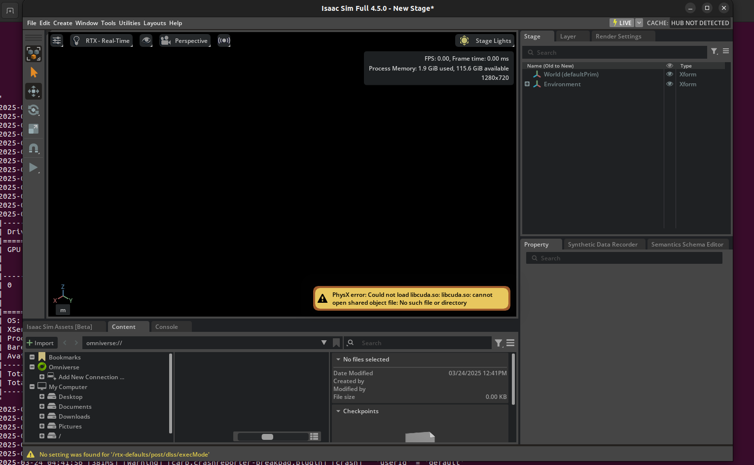

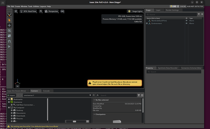

I run Isaacsim 4.5, GUI is shown for a while, then crash and report an error:
[Error] [omni.physx.plugin] PhysX error: Could not load libcuda.so: libcuda.so: cannot open shared object file: No such file or directory
, FILE /builds/omniverse/physics/physx/source/physx/src/gpu/PxPhysXGpuModuleLoader.cpp, LINE 204

Error Messages

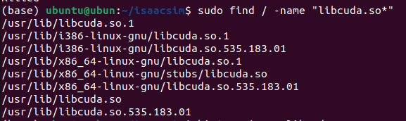

I check out my lib and find that libcuda.so exists. So, I run:
sudo ln -s /usr/lib/x86_64-linux-gnu/libcuda.so /usr/lib/
to link libcuda.so. But it didn’t work.
I tried ./post_install.sh, then ran Isaacsim, it still didn’t work.

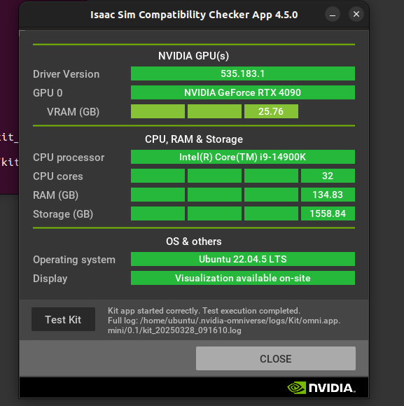

Have you checked if your system meets the requirements by running the Isaac Sim Compatibility Checker tool?
Yes. My system meets requirements. I have checked by running Isaac Sim Compatibility Checker.
Could you check if you run out of GPU VRAM?
There doesn’t seem to be anything wrong with the device…

GPU VRAM is fine.

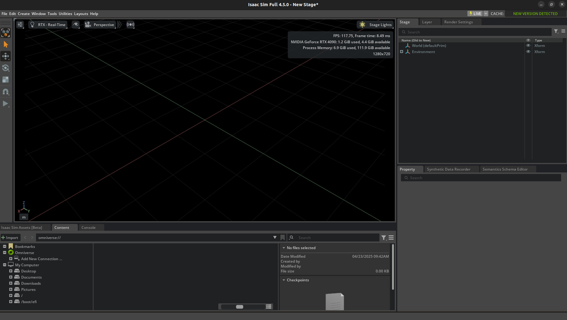

I tried to install isaacsim 4.5 in another computer which has a RTX 3090 GPU and Ubuntu 22.04 system. I ran isaacsim successfully. But if I run it in the computer with new GPU, it crashed.
Please try using the recommended driver versions 535.129.03 and 570.144, as mentioned in Isaac Sim Requirements — Isaac Sim Documentation. Also, please follow those note there:
We recommend installing the Latest Production Branch Version drivers from the Unix Driver Archive using the .run installer on Linux, if you are on a new GPU or experiencing issues with the current drivers.
After updating your drivers, if you still encounter this issue, could you check the first few messages that appear when launching Isaac Sim to locate the log file? Please reproduce the issue, and then upload the log file here so we can investigate further.

Could you try using the recommended driver versions 535.129.03 and 570.144?
I try to install driver version 570.144, but finally installed driver version 550.54, looks weird…
Surprisingly, it works. I run isaac sim successfully. Thank you for you help and patience, VickNV! I’m really grateful!
