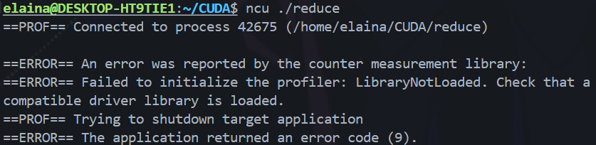

Hi, @Elaina-JKLove
Please check if your env meets below command
Profiling on Windows Subsystem for Linux (WSL) is only supported with WSL version 2. Profiling is supported on Windows 10 WSL with OS build version 19044 and greater, and NVIDIA display driver version 545 or higher. It is not supported on Windows 10 WSL for systems that exceed 1 TB of system memory. Profiling is supported on Windows 11 WSL with NVIDIA display driver version 525 or higher.
