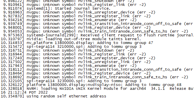

after update r32.1.1 Image
(1) dmesg
log_dmesg.txt (73.0 KB)

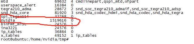

(2)lsmod
same issue as Orin Desktop version issue
This is basically just repeating that there is a “version” issue, though I couldn’t say exactly where. A subset of the dmesg log:
[    9.984872] nvgpu: Unknown symbol nvlink_register_link (err -2)
[    9.985145] nvgpu: Unknown symbol nvlink_unregister_device (err -2)
[    9.985379] nvgpu: Unknown symbol nvlink_unregister_link (err -2)
[    9.986353] nvgpu: Unknown symbol nvlink_enumerate (err -2)
[    9.986695] systemd-journald[297]: Received client request to flush runtime journal.
[    9.991819] nvgpu: Unknown symbol nvlink_transition_intranode_conn_off_to_safe (err -2)
[    9.991943] nvgpu: Unknown symbol nvlink_register_device (err -2)
[   10.014015] nvgpu: Unknown symbol nvlink_train_intranode_conn_safe_to_hs (err -2)
[   10.298572] nvgpu: Unknown symbol nvlink_shutdown (err -2)
[   10.298770] nvgpu: Unknown symbol nvlink_register_link (err -2)
[   10.299079] nvgpu: Unknown symbol nvlink_unregister_device (err -2)
[   10.299353] nvgpu: Unknown symbol nvlink_unregister_link (err -2)
[   10.299803] nvgpu: Unknown symbol nvlink_enumerate (err -2)
[   10.299971] nvgpu: Unknown symbol nvlink_transition_intranode_conn_off_to_safe (err -2)
[   10.300329] nvgpu: Unknown symbol nvlink_register_device (err -2)
[   10.300557] nvgpu: Unknown symbol nvlink_train_intranode_conn_safe_to_hs (err -2)
There were lots of symbol errors, not just those above, but those were for the GPU. A “symbol” is a fingerprint to a function to call, typically something like a combination of function name and arguments. When you configure a kernel and build it you are essentially selecting a series of symbols (think of each CONFIG_ item of a configuration as a bookmark into a group of symbols). An “unknown” symbol is one which is missing.
“Missing” symbols can be fulfilled either as being compiled into the kernel Image, or else being provided as a module. Keep in mind that if a module is missing or in some way incompatible with loading in that kernel Image, then this is also a missing symbol set even if you built the module. There is a good chance that something is wrong with your self-compiled kernel’s configuration, or the installation of modules (which could in turn be an issue of either invalid reuse of modules, or else new modules missing, or the modules being present but the kernel not knowing about them and in need of sudo depmod -a).
Do I need to recompile nvidia.ko and nvidia-modeset.ko?
Linux_for_Tegra/source/kernel/kernel-5.10
make ARCH=arm64 modules
make ARCH=arm64 modules_prepare
after succeed,
nvidia.ko and nvidia-modeset.ko are still not found !!!!!
Please use the source code from the tarball first. The problem looks like source_sync does not sync those code.
These modules install after running apply_binaries.sh script.
These modules located inside this package:
./kernel/nvidia-l4t-display-kernel_5.10.65-tegra-34.1.1-20220516211757_arm64.deb
I am not sure if you want to check the code or not. If you don’t want to build the code by yourself, then you can use @dimaz 's method too.
After I follow this installation, the display is still abnormal.
Lsmod looked and nvidia had it, but Nvidia-Modeset still didn’t
Still an error!!!
