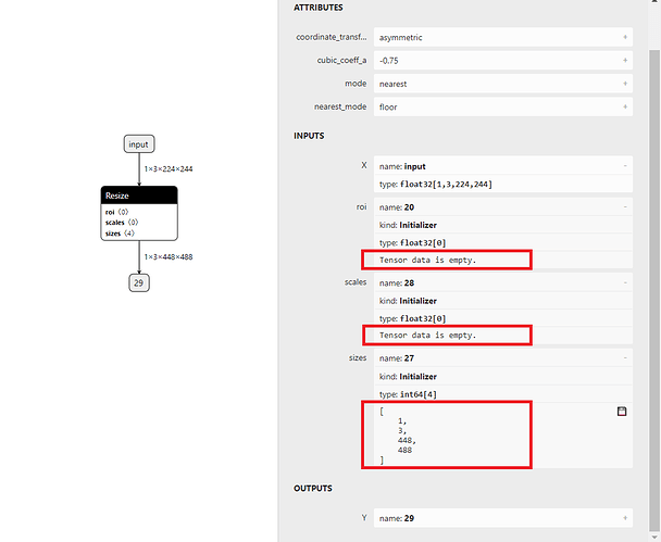

For TRT7, it checks all inputs whether tensor is filled with data.
If find any input is empty, TRT will report assertion error: Assertion failed: ctx->tensors().count(inputName)
But I think this assertion is not suitable for all operations.
For example, onnx Resize operation with opset 11, we just need to set either scales or sizes parameter.
TRT error:

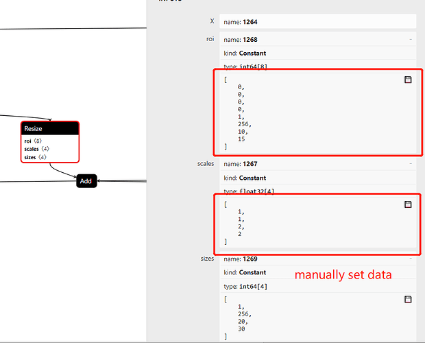

When I set data to rois and sizes by ONNX Python API, this error gone.
This issus occurs in all ONNX operations which has optional inputs.
