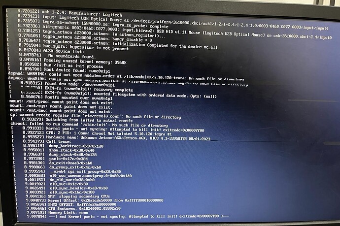

I have an AGX Xavier Devkit with a 500GB SSD installed. I want to flash Jetpack to this SSD such that the root partition covers almost the entire space. Flashing using Sdkmanager configures the RootFS to be 30GB by default.
I tried Workflow 3 (flashing to an external storage) from the README_initrd_flash.txt file with different parameters. This is the external partition layout file I used - flash_l4t_external.txt (9.7 KB). Following are the commands I tried and the results I got.
  1. sudo ADDITIONAL_DTB_OVERLAY_OPT=“BootOrderNvme.dtbo” ./tools/kernel_flash/l4t_initrd_flash.sh --external-device nvme0n1p1 -c ./tools/kernel_flash/flash_l4t_external.xml --showlogs jetson-agx-xavier-devkit nvme0n1p1
    The device flashes successfully but is unable to boot. The boot gets stuck, as shown in the image below.

Check this and let SDK Manager do the rest:
The issue got resolved by copying contents of “flash_l4t_t194_nvme.xml” to “flash_l4t_external.xml” and setting the APPSIZE and NUM_BLOCKS in the file, then using sdkmanager to flash. Seems like the problem was with the partition file. Thanks a lot!
