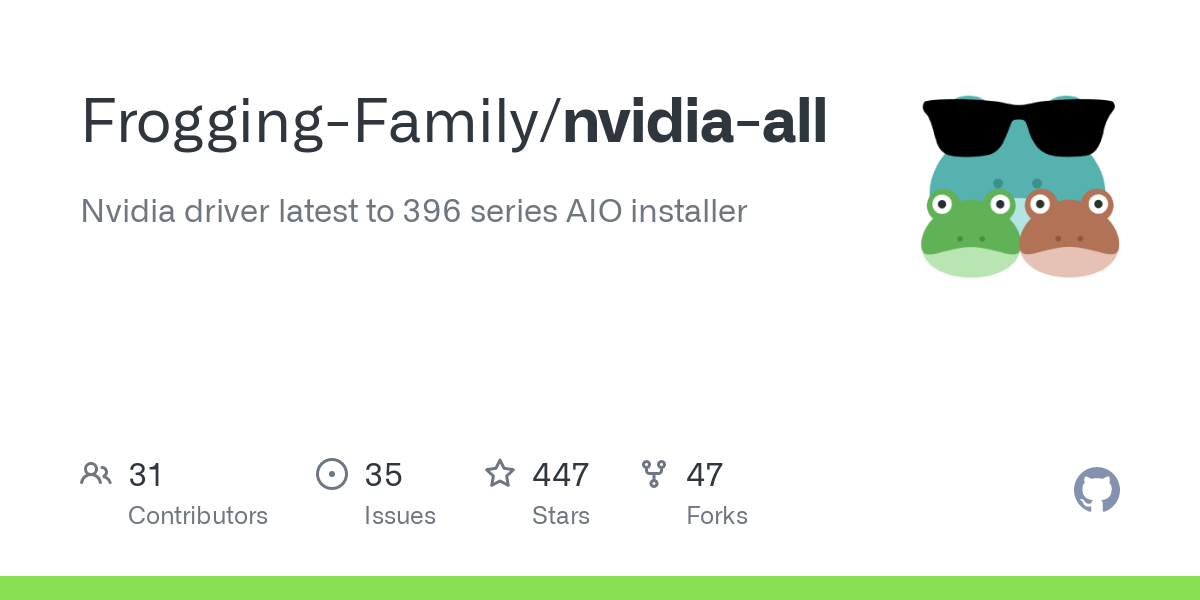

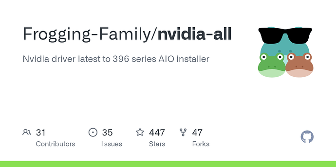

I’m using driver 525.125.06 together with kernel 6.5.7 on Arch Linux.
I installed it using Nvidia-All:
