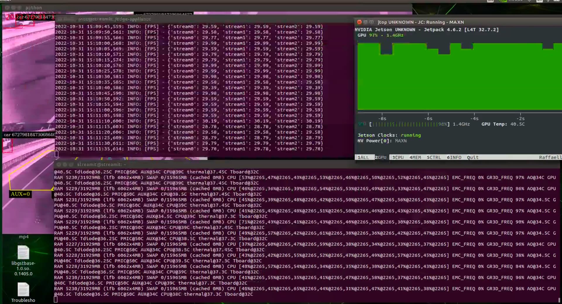

Why would i wait 12hours when after 3 i’m getting almost 0FPS? GPU and CPU performance looks great at start, but after the 3 hours and when the FPS start dropping it just change with no sense.
The first screenshot shows the FPS when the camera just started, everything good (29.9fps).
The time was 15:11

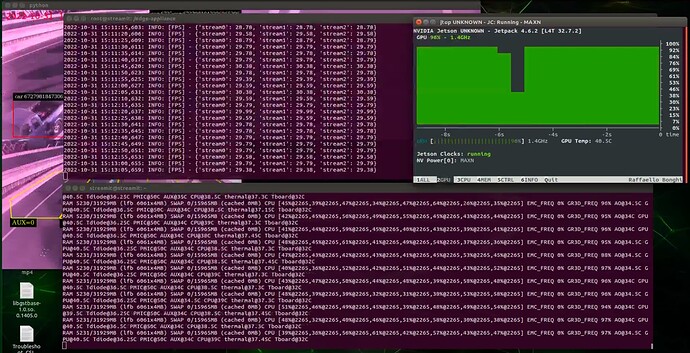

2
By 16:54 got to 25FPS and will continue dropping to 0.
And GPU and CPU looks weird, Notice one of the CPU is 100%, but it changes from one to other.

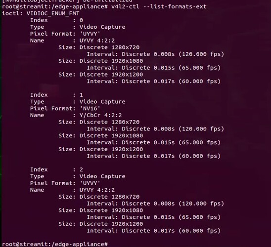

Which kind of camera are you using(CSI, USB or IP camera)? What is the format of your camera? How many camera sources are you using? How did you measure FPS?
@Fiona.Chen GMSL Camera, I measure the frames as in the deepstream-app-3 using the PERF_DATA class.
I have up to 4 cameras in a Jetson AGX, but i have been doing test with a single camera and still have drops.
