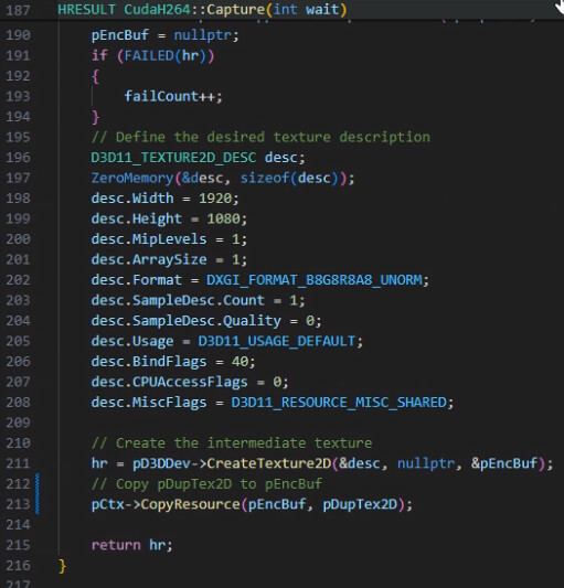

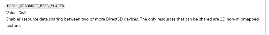

After some debugging I found out that maybe it came from my Direct3D texture’s description (the ID3D11Resource*). So I tried to use cudaGraphicsD3D11RegisterResource with a copy of my DXGI desktop grabbed texture (ID3D11Resource* pDupTex2D variable in my code) with a slight change in the desc. And then the function cudaGraphicsD3D11RegisterResource worked with a texture that had in it’s desc → MiscFlags = D3D11_RESOURCE_MISC_SHARED.
TLDR : My texture was the reason why I had CUDA_ERROR_INVALID_HANDLE because of a MiscFlags field in the texture’s description.
Although I don’t like the idea of having to do a copy of my frame everytime i grab it, I guess i don’t have the choice if it’s required for CUDA runtime API functions
But now I’m encountering another error with mapping now, it’s returning 400 too it’s maybe my texture’s desc again ?
Yeah I’m stuck again on another function.
So here I made a copy with createTexture2D and CopyResources to solve my previous problem with the RegisterResource
