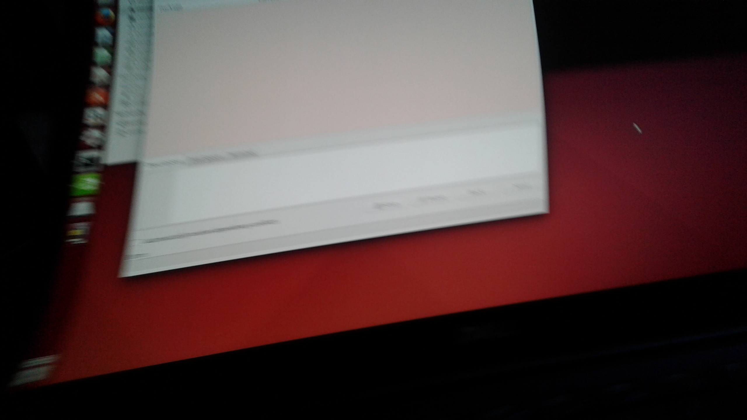

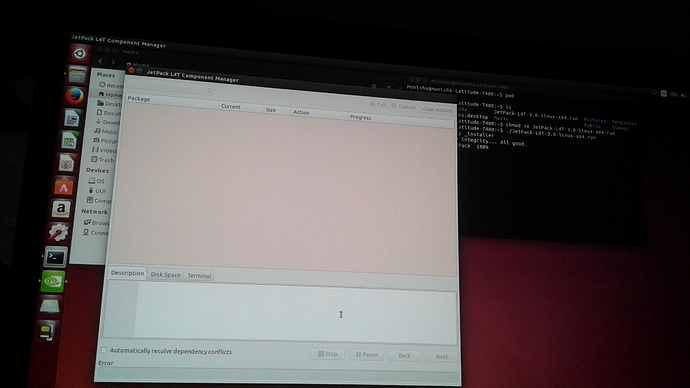

While executing the Jetpack 3.0 exe in the Ubuntu 14.04, I reach the screen where we need to select the different packages for installation. I am not able to see any of those packages.
I see the message ‘Downloading update lock’ at the bottom of the screen. It keeps appearing for a while and after that I see an Error.
It basically does not show the different packages for installation of the Jetpack 3.0.
Attached the screenshots. Are you able to see it?
Is the host x86 Ubuntu 14.04 host where you’re running JetPack connected to Internet ?
Later, it may also be required that your Jetson has direct Internet access for downloading packages (through a firewall/proxy requiring authentification may be a problem).
No, it was not connected to the internet. Let me try with that.
It may help…
Be also aware that having your jetson connected to internet with ubuntu and nvidia standard passwords is a security hole.
