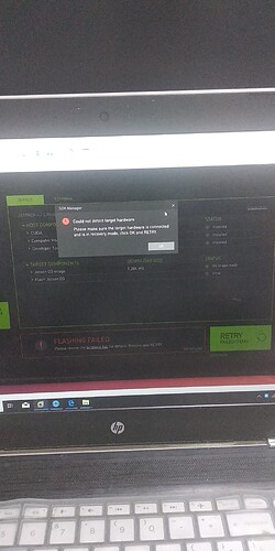

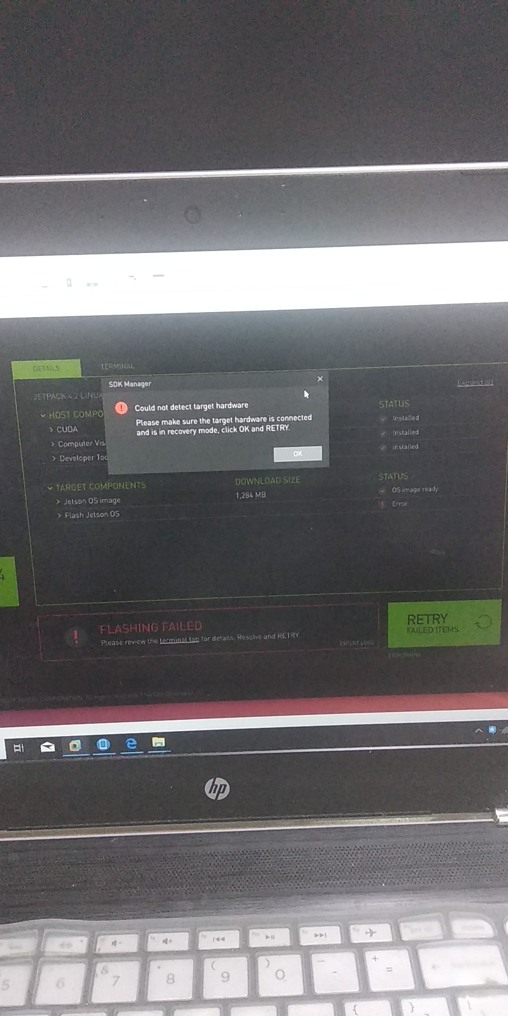

My TX2 is turned on, there is no original UNBUNTU system.
I reloaded with sdkmanager, but it always gives an error when jetson os14.3
But my usb is connected.

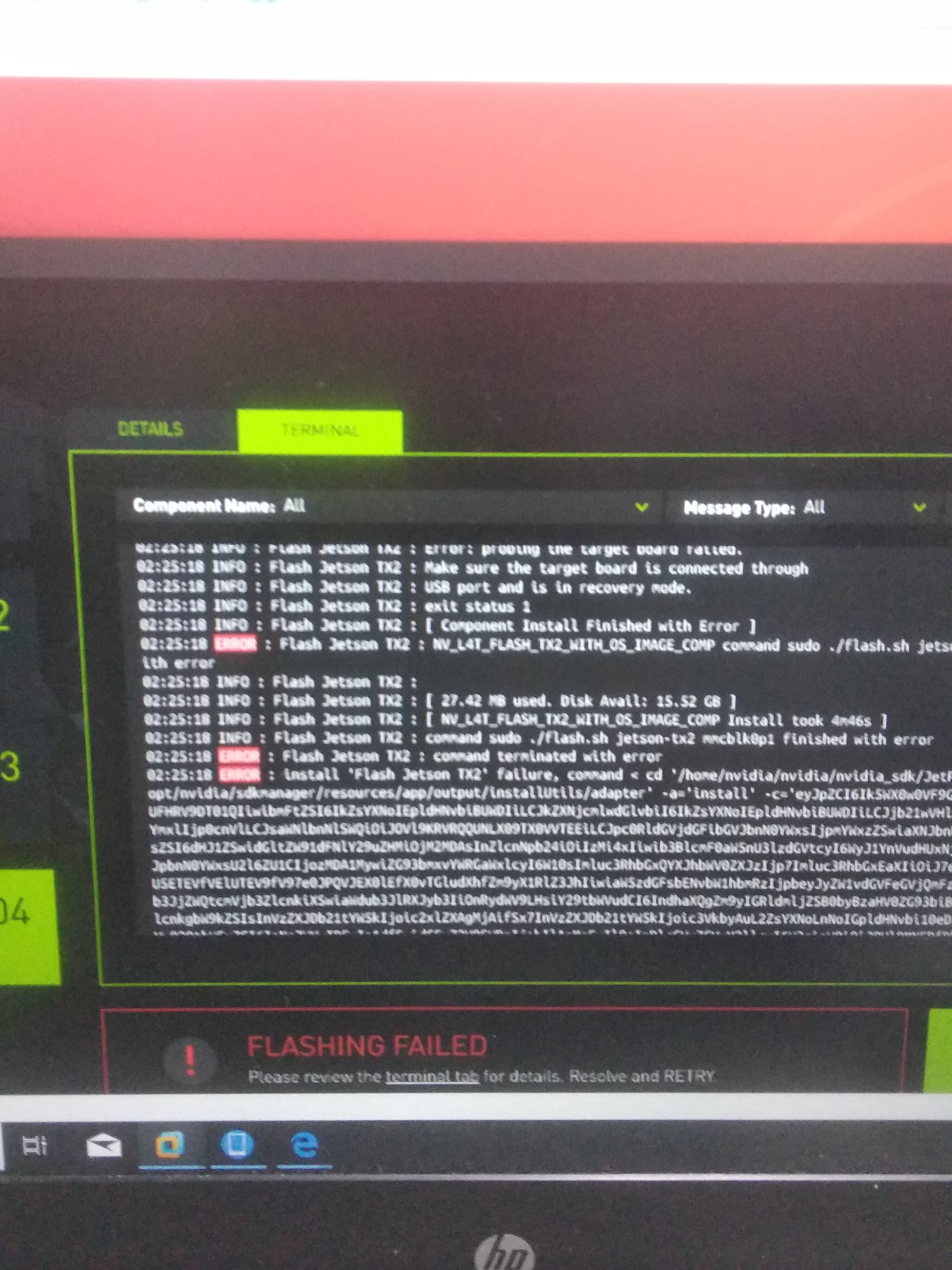

02:25:18 ERROR : Flash Jetson TX2 : NV_L4T_FLASH_TX2_WITH_OS_IMAGE_COMP command sudo ./flash.sh jetson-tx2 mmcblk0p1 finished with error
02:25:18 INFO : Flash Jetson TX2 :
02:25:18 INFO : Flash Jetson TX2 : [ 27.42 MB used. Disk Avail: 15.52 GB ]
02:25:18 INFO : Flash Jetson TX2 : [ NV_L4T_FLASH_TX2_WITH_OS_IMAGE_COMP Install took 4m46s ]
02:25:18 INFO : Flash Jetson TX2 : command sudo ./flash.sh jetson-tx2 mmcblk0p1 finished with error
02:25:18 ERROR : Flash Jetson TX2 : command terminated with error
02:25:18 ERROR : install ‘Flash Jetson TX2’ failure, command < cd ‘/home/nvidia/nvidia/nvidia_sdk/JetPack_4.2_Linux_P3310’ ; ‘/opt/nvidia/sdkmanager/resources/app/output/installUtils/adapter’ -a=‘install’ -c=‘eyJpZCI6Ik5WX0w0VF9GTEFTSF9UWDJfV0lUSF9PU19JTUFHRV9DT01QIiwibmFtZSI6IkZsYXNoIEpldHNvbiBUWDIiLCJkZXNjcmlwdGlvbiI6IkZsYXNoIEpldHNvbiBUWDIiLCJjb21wVHlwZSI6ImZsYXNoIiwiaXNWaXNpYmxlIjp0cnVlLCJsaWNlbnNlSWQiOiJOVl9KRVRQQUNLX09TX0VVTEEiLCJpc0RldGVjdGFibGVJbnN0YWxsIjpmYWxzZSwiaXNJbnN0YWxsUGF0aEN1c3RvbWl6YWJsZSI6dHJ1ZSwidGltZW91dFNlY29uZHMiOjM2MDAsInZlcnNpb24iOiIzMi4xIiwib3BlcmF0aW5nU3lzdGVtcyI6WyJ1YnVudHUxNjA0IiwidWJ1bnR1MTgwNCJdLCJpbnN0YWxsU2l6ZU1CIjozMDA1MywiZG93bmxvYWRGaWxlcyI6W10sImluc3RhbGxQYXJhbWV0ZXJzIjp7Imluc3RhbGxEaXIiOiJ7e1RBUkdFVF9ST09UfX0ve3tCVU5ETEVfVElUTEV9fV97e0JPQVJEX0lEfX0vTGludXhfZm9yX1RlZ3JhIiwiaW5zdGFsbENvbW1hbmRzIjpbeyJyZW1vdGVFeGVjQmFzaCI6WyJzdWRvIHJlYm9vdCBmb3JjZWQtcmVjb3ZlcnkiXSwiaWdub3JlRXJyb3IiOnRydWV9LHsiY29tbWVudCI6IndhaXQgZm9yIGRldmljZSB0byBzaHV0ZG93biBhbmQgdG8gZ28gdG8gcmVjb3ZlcnkgbW9kZSIsInVzZXJDb21tYW5kIjoic2xlZXAgMjAifSx7InVzZXJDb21tYW5kIjoic3VkbyAuL2ZsYXNoLnNoIGpldHNvbi10eDIgbW1jYmxrMHAxIn0seyJ1c2VyQ29tbWFuZCI6InNsZWVwIDEwIn1dfSwidGFyZ2V0SWRzIjpbIlAzMzEwIl0sImRlcGVuZGVuY2llcyI6W3siaWQiOiJOVl9MNFRfRklMRV9TWVNURU1fQU5EX09TX1RYMl9DT01QIiwib3BlcmF0b3IiOiI9PSIsInZlciI6IjMyLjEiLCJfaWQiOiJOVl9MNFRfRklMRV9TWVNURU1fQU5EX09TX1RYMl9DT01QQFAzMzEwIn0seyJpZCI6Ik5WX0w0VF9EUklWRVJTX1RYMl9DT01QIiwib3BlcmF0b3IiOiI9PSIsInZlciI6IjMyLjEiLCJfaWQiOiJOVl9MNFRfRFJJVkVSU19UWDJfQ09NUEBQMzMxMCJ9LHsiaWQiOiJOVl9MNFRfREVWSUNFX01PREVfU0VUVVBfQ09NUF9JTl9GTEFTSCIsIm9wZXJhdG9yIjoiPT0iLCJ2ZXIiOiIxLjAiLCJfaWQiOiJOVl9MNFRfREVWSUNFX01PREVfU0VUVVBfQ09NUF9JTl9GTEFTSEBQMzMxMCJ9XSwiZXh0ZXJuYWxfZGVwZW5kZW5jaWVzIjpbXSwidGFyZ2V0SUQiOiJQMzMxMCIsIl9pZCI6Ik5WX0w0VF9GTEFTSF9UWDJfV0lUSF9PU19JTUFHRV9DT01QQFAzMzEwIiwicGFyZW50SUQiOiJOVl9EUklWRV9GTEFTSF9UQVJHRVRfR1JPVVAiLCJfcGFyZW50SUQiOiJOVl9EUklWRV9GTEFTSF9UQVJHRVRfR1JPVVBAUDMzMTAiLCJpbnN0YWxsU3RhdHVzIjoibm9uZSIsImFjdGlvbiI6MSwiaW5zdGFsbFBhdGgiOiIvaG9tZS9udmlkaWEvbnZpZGlhL252aWRpYV9zZGsvSmV0UGFja180LjJfTGludXhfUDMzMTAiLCJkb3dubG9hZEVycm9ycyI6W10sImJ1bmRsZVRpdGxlIjoiSmV0UGFja180LjJfTGludXgiLCJpbnN0YWxsUm9vdCI6Ii9ob21lL252aWRpYS9udmlkaWEvbnZpZGlhX3NkayIsImJvYXJkSUQiOiJQMzMxMCIsInRhcmdldEFjY2Vzc0luZm8iOnsidXNlciI6Im52aWRpYSIsInBhc3N3b3JkIjoibnZpZGlhIiwiaG9zdCI6IjE5Mi4xNjguNTUuMSIsInBvcnQiOiIyMiJ9LCJpc0RyeVJ1biI6ZmFsc2V9’ -i=‘NV_L4T_FLASH_TX2_WITH_OS_IMAGE_COMP’ -v=‘32.1’ -l=‘/home/nvidia/nvidia/nvidia_sdk/JetPack_4.2_Linux_P3310’ -L=‘/home/nvidia/.nvsdkm/logs/JetPack_4.2_Linux’ -p=‘2554’ -t=‘P3310’ -e=‘undefined’ > terminated with error

Some questions for you:
  • Is the host a VM, or native?
  • Are you using the original micro-B USB cable which shipped with the TX2?
  • Is this the dev kit or an alternate carrier board?
  • Is the TX2 starting in recovery mode?
Notes:
  • VMs are not supported. They can work if you give complete ownership of the device to the guest o/s, but otherwise tend to lose USB as USB stops and starts.
  • Many micro-USB cables fail at data and tend to be for charging.

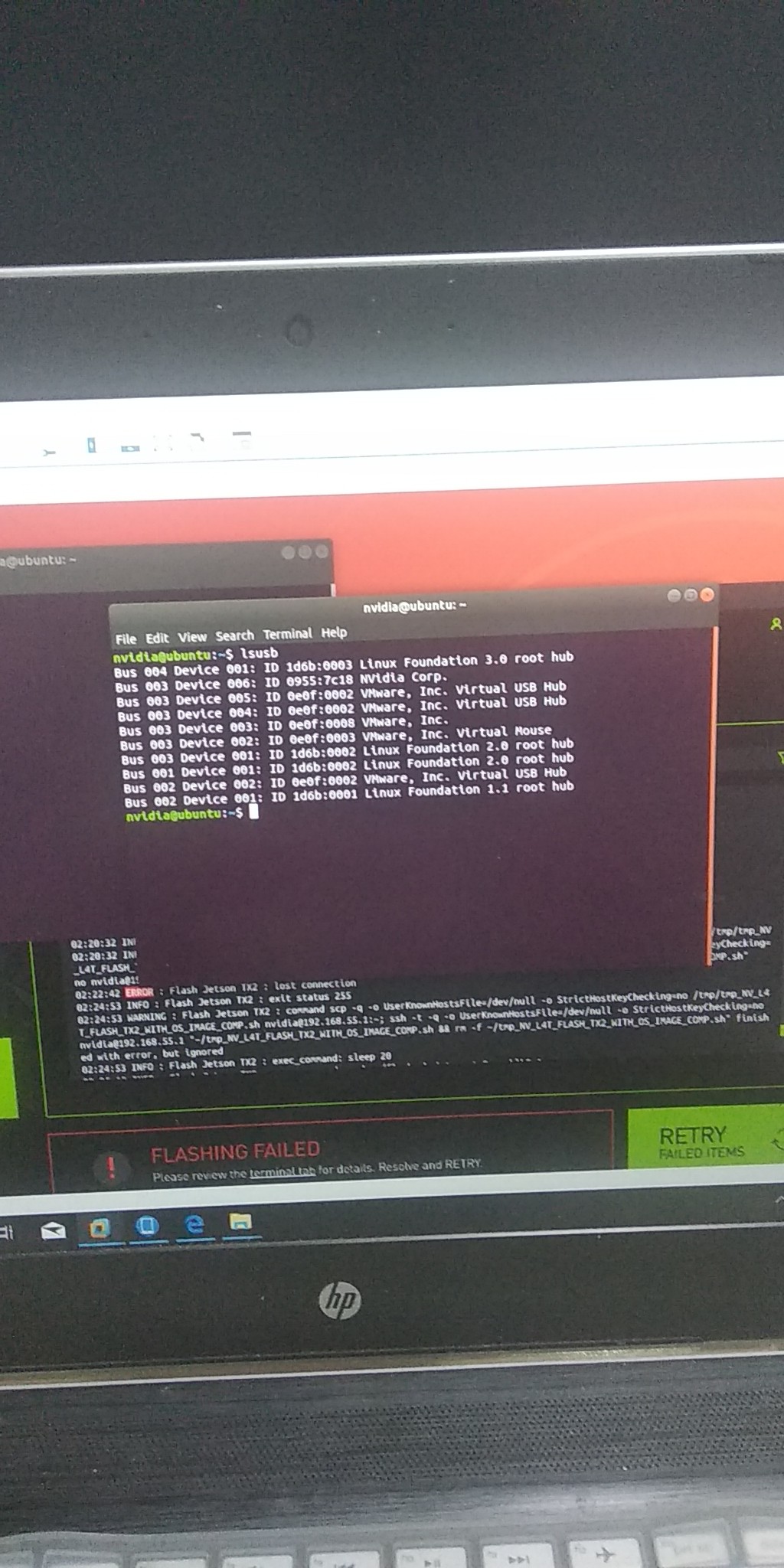

1.The host is VM.2.I used the original micro-B USB.3.I print lsusb and the nvidia crop is connection.4.This is a development board.5. in recovery mode6.
And I suspect that there is a problem with the firmware file path.
When Jent os is installed to 14.3%, it will be disconnected.
The main error is
exec_command: scp -q -o UserKnownHostsFile=/dev/null -o StrictHostKeyChecking=no /tmp/tmp_NV_L4T_FLASH_TX2_WITH_OS_IMAGE_COMP.sh nvidia@192.168.55.1:~; ssh -t -q -o UserKnownHostsFile=/dev/null -o StrictHostKeyChecking=no nvidia@192.168.55.1 “~/tmp_NV_L4T_FLASH_TX2_WITH_OS_IMAGE_COMP.sh && rm -f ~/tmp_NV_L4T_FLASH_TX2_WITH_OS_IMAGE_COMP.sh”
18:56:55 ERROR : Flash Jetson TX2 : lost connection
And I turned off the host’s firewall and still lost the connection.

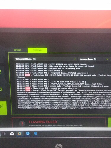

02:25:20 INFO : All done!
FLASHING FAILED
I found that although the host recognized the USB, it could not transfer data. What is the problem?

The USB issue is caused by the VM. During normal flash USB drops and reconnects…the VM fails to pick the USB back up upon reconnect and the hosting o/s is taking the USB. You have to adjust the VM to give the guest o/s complete ownership regardless of USB disconnect and reconnect.
Btw, what @hosyp11 mentions is related. There is a virtual USB ethernet device created for a fully booted TX2. This too much be passed through to the VM guest from the host o/s, but this won’t occur until flash completes and the TX2 reboots for install of extra packages. I don’t know which release you are using, but instructions on the network part after flash completes and extra package addition stage is reached will change depending on release.
I just installed Jentos for tx2, this process does not need to connect to TX2 with network wire.And I found the USB device is can’t Whether it’s ubuntu or windows, I found that usb can’t access the devices it’s connected to. Ubuntu just shows the connection, but can’t access the device. Windows does not display the connection of usb at all. Perhaps it is a hardware problem.
And the original UNBUTU of this TX2 can’t be accessed, and I can’t get the IP address it assigned.
