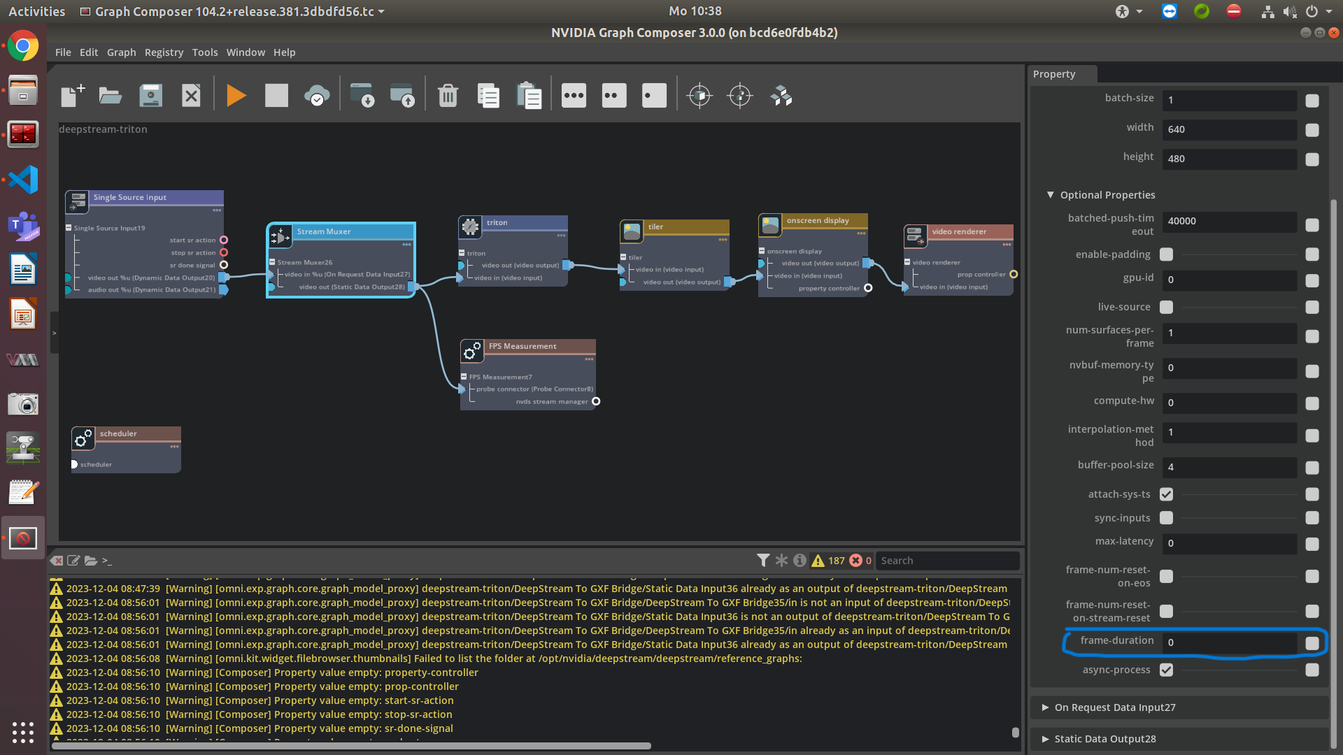

I have the following triton pipeline in Graph Composer and for testing I am using multiple videos with different FPS (10, 30, 60, 100, 300 FPS) however, no matter how many FPS my source has, the output from the Mux and the Pipeline is 60 FPS.
I trided setting the frame-duration in the NvDsStreamMux properties to 10000 (for 10FPS), but the output from the Mux is still at 60FPS. Setting this parameter to zero (as mentioned in the documentation) still resulted in 60FPS output. Is there a way to achieve this, or do I have to implement my own variable FPS Gstreamer plug-in?

There is no such property or parameter. NvDsMuxDemuxExt — DeepStream 6.3 Release documentation
What do you want to achieve? To change the FPS of the streams or the FPS of the batched stream?
I can find it in Graph Composer under Optional properties.
I want to change the FPS of the input to my network, so I assume the batched stream would make more sense in this case.
Please check the parameter here: Gst-nvstreammux — DeepStream 6.3 Release documentation
I sadly couldn’t find anything helpful there. However, I switched to the Gst-nvstreammux New which provides a max and min fps control that seemed to work for me.
