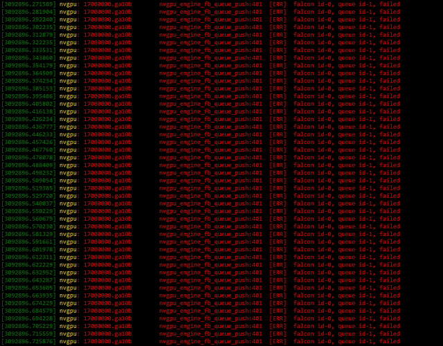

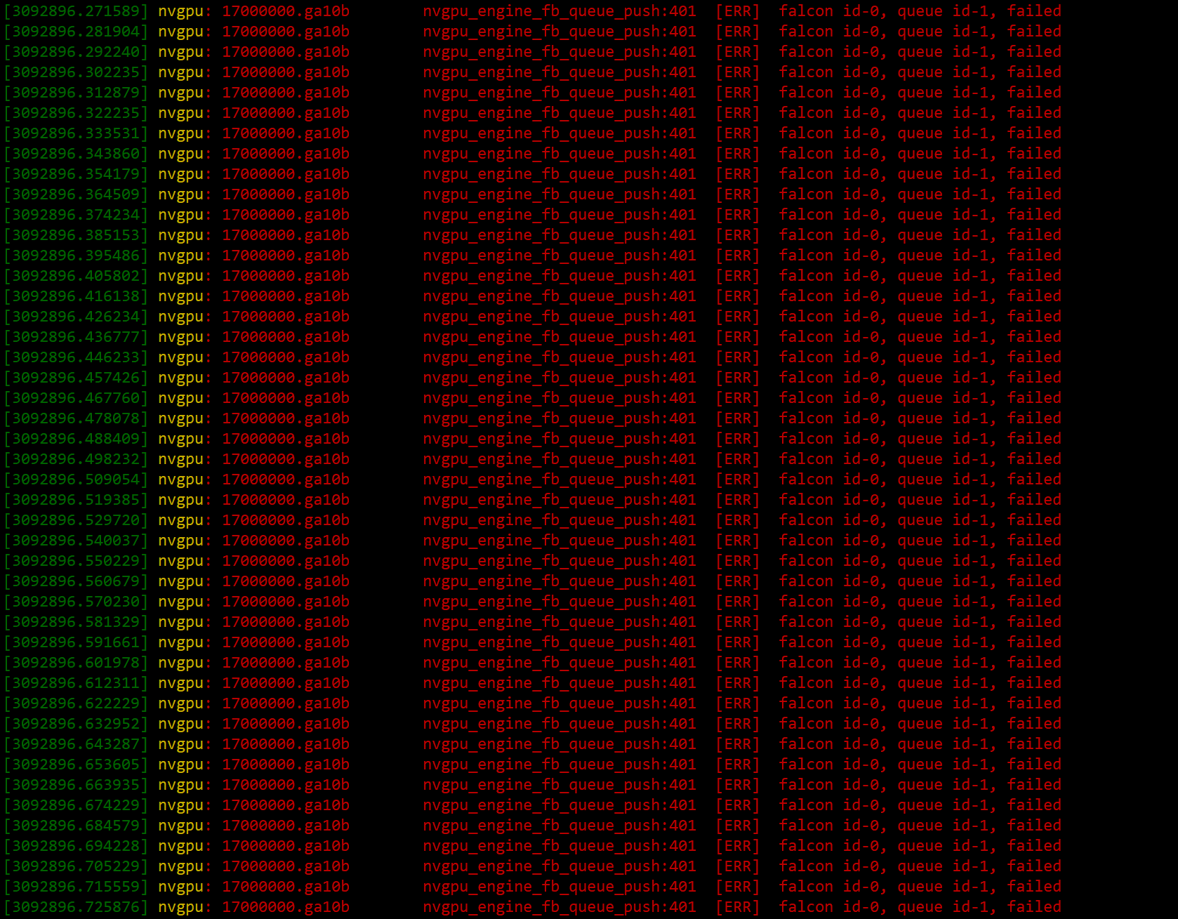

[4396822.611090] nvgpu: 17000000.ga10b gv100_pmu_lsfm_init_acr_wpr_region:53   [ERR]  Failed to execute RPC status=0xfffffff4
[4396822.622334] nvgpu: 17000000.ga10b nvgpu_pmu_lsfm_bootstrap_ls_falcon:107  [ERR]  LSF init WPR region failed
[4396822.622628] nvgpu: 17000000.ga10b nvgpu_pmu_lsfm_bootstrap_ls_falcon:128  [ERR]  LSF Load failed
[4396822.622882] nvgpu: 17000000.ga10b nvgpu_gr_falcon_load_secure_ctxsw_ucode:714  [ERR]  Unable to recover GR falcon
[4396822.623162] nvgpu: 17000000.ga10b        nvgpu_gr_falcon_init_ctxsw:159  [ERR]  fail
[4396822.623385] nvgpu: 17000000.ga10b nvgpu_cic_mon_report_err_safety_services:92   [ERR]  Error reporting is not supported in this platform
[4396822.623718] nvgpu: 17000000.ga10b      gr_init_ctxsw_falcon_support:833  [ERR]  FECS context switch init error
[4396822.624002] nvgpu: 17000000.ga10b            nvgpu_finalize_poweron:1010 [ERR]  Failed initialization for: g->ops.gr.gr_init_support
[4396822.650606] nvgpu: 17000000.ga10b                 gk20a_power_write:127  [ERR]  power_node_write failed at busy
[4396833.710180] nvgpu: 17000000.ga10b                nvgpu_pmu_cmd_post:591  [ERR]  FBQ cmd setup failed
[4396833.710484] nvgpu: 17000000.ga10b             nvgpu_pmu_rpc_execute:713  [ERR]  Failed to execute RPC status=0xfffffff4, func=0x0
[4396833.710817] nvgpu: 17000000.ga10b gv100_pmu_lsfm_init_acr_wpr_region:53   [ERR]  Failed to execute RPC status=0xfffffff4
[4396833.722072] nvgpu: 17000000.ga10b nvgpu_pmu_lsfm_bootstrap_ls_falcon:107  [ERR]  LSF init WPR region failed
[4396833.722377] nvgpu: 17000000.ga10b nvgpu_pmu_lsfm_bootstrap_ls_falcon:128  [ERR]  LSF Load failed
[4396833.722624] nvgpu: 17000000.ga10b nvgpu_gr_falcon_load_secure_ctxsw_ucode:714  [ERR]  Unable to recover GR falcon
[4396833.722910] nvgpu: 17000000.ga10b        nvgpu_gr_falcon_init_ctxsw:159  [ERR]  fail
[4396833.723122] nvgpu: 17000000.ga10b nvgpu_cic_mon_report_err_safety_services:92   [ERR]  Error reporting is not supported in this platform
[4396833.723459] nvgpu: 17000000.ga10b      gr_init_ctxsw_falcon_support:833  [ERR]  FECS context switch init error
[4396833.723726] nvgpu: 17000000.ga10b            nvgpu_finalize_poweron:1010 [ERR]  Failed initialization for: g->ops.gr.gr_init_support
[4396833.750693] nvgpu: 17000000.ga10b                 gk20a_power_write:127  [ERR]  power_node_write failed at busy
[4396835.626139] nvgpu: 17000000.ga10b                nvgpu_pmu_cmd_post:591  [ERR]  FBQ cmd setup failed
[4396835.626429] nvgpu: 17000000.ga10b             nvgpu_pmu_rpc_execute:713  [ERR]  Failed to execute RPC status=0xfffffff4, func=0x0
[4396835.626782] nvgpu: 17000000.ga10b gv100_pmu_lsfm_init_acr_wpr_region:53   [ERR]  Failed to execute RPC status=0xfffffff4
[4396835.638032] nvgpu: 17000000.ga10b nvgpu_pmu_lsfm_bootstrap_ls_falcon:107  [ERR]  LSF init WPR region failed
[4396835.638327] nvgpu: 17000000.ga10b nvgpu_pmu_lsfm_bootstrap_ls_falcon:128  [ERR]  LSF Load failed
[4396835.638578] nvgpu: 17000000.ga10b nvgpu_gr_falcon_load_secure_ctxsw_ucode:714  [ERR]  Unable to recover GR falcon
[4396835.638875] nvgpu: 17000000.ga10b        nvgpu_gr_falcon_init_ctxsw:159  [ERR]  fail
[4396835.639104] nvgpu: 17000000.ga10b nvgpu_cic_mon_report_err_safety_services:92   [ERR]  Error reporting is not supported in this platform
[4396835.639436] nvgpu: 17000000.ga10b      gr_init_ctxsw_falcon_support:833  [ERR]  FECS context switch init error
[4396835.639702] nvgpu: 17000000.ga10b            nvgpu_finalize_poweron:1010 [ERR]  Failed initialization for: g->ops.gr.gr_init_support
[4396835.665634] nvgpu: 17000000.ga10b                 gk20a_power_write:127  [ERR]  power_node_write failed at busy
[4396846.765863] nvgpu: 17000000.ga10b                nvgpu_pmu_cmd_post:591  [ERR]  FBQ cmd setup failed
[4396846.766156] nvgpu: 17000000.ga10b             nvgpu_pmu_rpc_execute:713  [ERR]  Failed to execute RPC status=0xfffffff4, func=0x0
[4396846.766537] nvgpu: 17000000.ga10b gv100_pmu_lsfm_init_acr_wpr_region:53   [ERR]  Failed to execute RPC status=0xfffffff4
[4396846.777774] nvgpu: 17000000.ga10b nvgpu_pmu_lsfm_bootstrap_ls_falcon:107  [ERR]  LSF init WPR region failed
[4396846.778082] nvgpu: 17000000.ga10b nvgpu_pmu_lsfm_bootstrap_ls_falcon:128  [ERR]  LSF Load failed
[4396846.778331] nvgpu: 17000000.ga10b nvgpu_gr_falcon_load_secure_ctxsw_ucode:714  [ERR]  Unable to recover GR falcon
Our equipment is still malfunctioning, please assist in analyzing the cause. We will try our best to continuously power on and restart to destroy the malfunction。

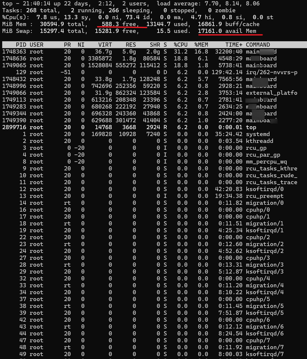

We default to enabling maximum power consumption, but the clock is not locked and the GPU has not been called for a long time. Did the GPU enter low-power mode due to prolonged inactivity
Before the error message “libnvrm_gpu. so: NvRmGpuLibOpen failed, error=6” was reported, the system had very little free memory space and both jtop and tegrastats entered were stuck. May I ask if these situations are related to the error message?

  1. No hardware watchdog has been set up. We suspect that the oom killer mechanism was triggered due to the depletion of system memory, resulting in the killing of GPU related services. Due to the 7-day rotation of system logs, no relevant logs were captured.
