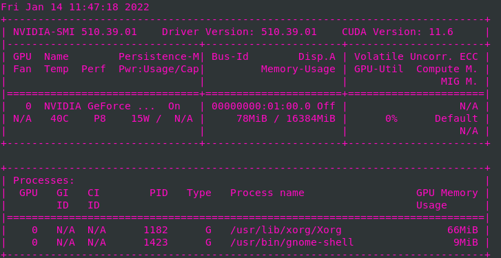

I was trying to set up graph composer to test some of the new features. I followed the guidelines from the installing graph composer and I successfully installed the software.
The problem is that when I try to run the $composer in the terminal, the following output appears and the app doesn’t seem to launch:
I already tried the same operation but using the 470 from nvidia, and the 490 version aswell. In all these cases the output remained the same.
The following log was provided while running the command:
kit_20220114_114055.log (82.6 KB)
I’m a little bit lost here, I have already checked some other questions posted in the forums related to this issue but in my case the nvidia drivers seem to be working properly, and all the required packages for graph composer have been correctly installed.
Lastly I’m uploading a screenshot from nvidia-smi in my device, showing that the drivers are operative:
Any inputs regarding the issue are welcome, thank you for your time.

Do you run the composer in docker container?
No, I run it locally
