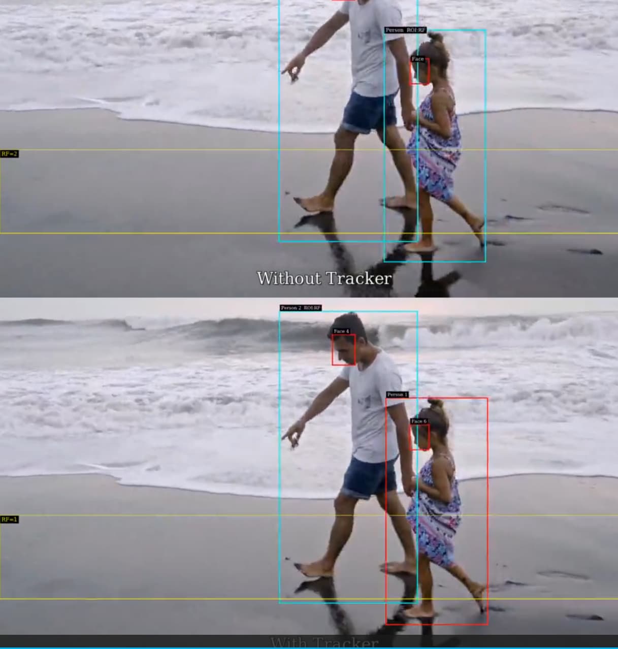

I have been testing the nvdsanalytics element to determine the presence of persons in a region, however I am having inconsistent results. It was my understanding that the analytics will determine that an object is in the ROI if the bottom center coordinate is inside the defined region, however I get object bounding boxes classified in the ROI when the bottom line is outside the region and bounding boxes not detected in the ROI when the bottom line is inside the region.
Following example shows how in some occasions the man is detected inside the RT ROI when the bottom bounding box line is outside the region:
On the other hand next video shows the man is not detected in ROI even when the bottom line of the bounding box is inside the ROI-RF:
Also I am getting different results depending on the detector that I use, I tested with peoplenet and rtmdet, with the same video and pipeline, even tough I get similar bounding boxes, the analytics ROI detections are different, see below:

We completed the tests. Here is what we found:
  1. We tested the sample application you suggested with the videos and we reproduced your results. Using the application the ROI detects the bounding box correctly.
  2. When checking the application, we realized it uses the tracker after the detector.
  3. When we add the tracker to the original GStreamer pipeline (as shown below) the results are the same than when using the application i.e. the detection within the ROI is correct.
gst-launch-1.0 filesrc location= test-walking1.mp4 ! qtdemux ! h264parse ! nvv4l2decoder ! .sink_0 nvstreammux name=m width=1920 height=1080 batch-size=1 ! nvinfer config-file-path= peoplenet/config_infer_primary_peoplenet.txt ! nvtracker ll-lib-file=“/opt/nvidia/deepstream/deepstream/lib/libnvds_nvmultiobjecttracker.so” ll-config-file=“/opt/nvidia/deepstream/deepstream/samples/configs/deepstream-app/config_tracker_NvDCF_perf.yml” tracker-width=640 tracker-height=480 ! nvdsanalytics config-file=config.txt ! nvvideoconvert ! nvdsosd ! nvvideoconvert ! nvv4l2h264enc ! h264parse ! avimux ! filesink location=/tmp/test.avi
  1. The following videos show the difference between using the tracker and not using it with the sample videos:
For our use case, using the tracker is not necessary, we only need to detect whether the detection occurs within the ROI or not. That said, our questions is:
Is it required to use the tracker to get the analytics detecting the bounding box in the ROI correctly?
You can easily test this by removing the tracker in your application or using the GStreamer pipeline without tracker.

without tracker, using the same video and cfg, I can reproduce this issue. that is, when the bottom center coordinate (x_left + width/2, y_top + height) did not enter the ROI, the ROI count increased. we are checking then get back to you. Thanks!

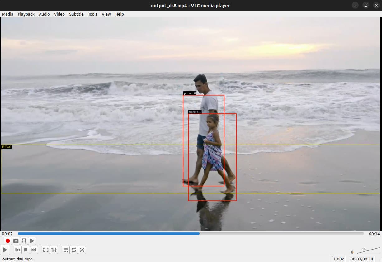

I’ve encountered similar issues.
I was a bit surprised to see you confirm the results as correct with the tracker… What are your thoughts on these screenshots from certain frames?
On my side, I’ve also noticed some inconsistencies in line crossings.
@fanzh Is there a patch available?
Thank you
@simon.renuart I am not able to reprodcue this issue with the latest version. could you try the latest nvcr.io/nvidia/deepstream:8.0-triton-multiarch? If the issue persists at your end, please share the test video, cfg. Thanks!
On my side, the issue is still there :

Just to confirm: in the sample I am testing, the tracker is already enabled, so the current accuracy issue is not related to the absence of tracking. The bug is still present even with the tracker in the pipeline.
Regarding the point about “nvdsanalytics uses the bboxes of the same object in consecutive frames, not only one object, hence a tracker is needed for recognizing the same object in consecutive frames”: I would like to clarify that statement. By design, the tracker is precisely what ensures that bounding boxes from frame to frame are associated with the same object ID. nvdsanalytics then consumes these tracked objects. So the supposed requirement (“tracker is needed”) is already satisfied in the tested setup.
In other words, the accuracy issue we are observing cannot be explained simply by the lack of a tracker, since one is already present and functioning.
Could you please confirm if there are any known limitations or additional configuration parameters in nvdsanalytics that might explain this behavior?
