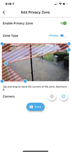

Because… I’m finding that it works except when objects are on the bottom edge of the frame like this example:
Here is a photo of what the region of interest looks like superimposed on a camera.

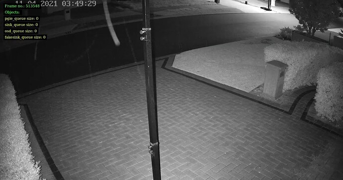

Here is an example video showing the ROI not working.
At about 3.5 seconds into the clip a red shaded bounding box is shown for one frame. This was correctly detected as in the inverse ROI so should be ignored (to do so I have coloured the box red to show).
But then the very next frame is a problem. The box is not shaded which means the ROI checking has failed. This box should be ignored as the bottom centre point is within the inverse ROI area.
What I do notice however is that the box coordinates are right at the bottom and left of the screen. So the y-coordinate of the bottom centre point being checked is 1080 (1080p video feed).
Could this be an off-by-one error in the nvdsanalytics code that checks whether a point is inside an ROI or not? If its not a bug how can I handle this situation because it means any bbox that touches the bottom of the frame does not with with ROI filtering?

Hey Jason,
the problem here shuold be the point is on the ROI boundary and in that scenario if its normal ROI it would be considered in but in case of inverse roi its not of in, so the boundary is not included in that scenario.
Correct.
Thanks @bcao thats helps.
So to confirm if it’s a normal ROI then the line IS included.
If it’s an Inverse ROI then it excludes the line.
Yeah, exactly.
