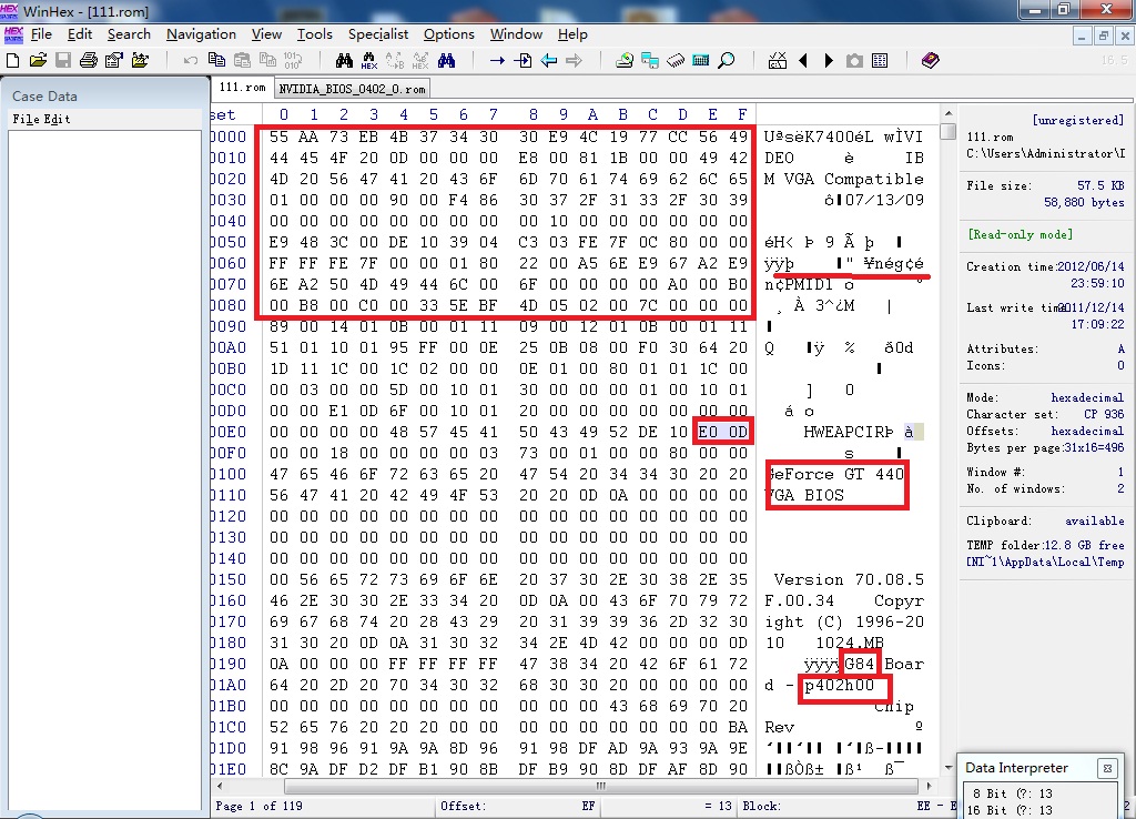

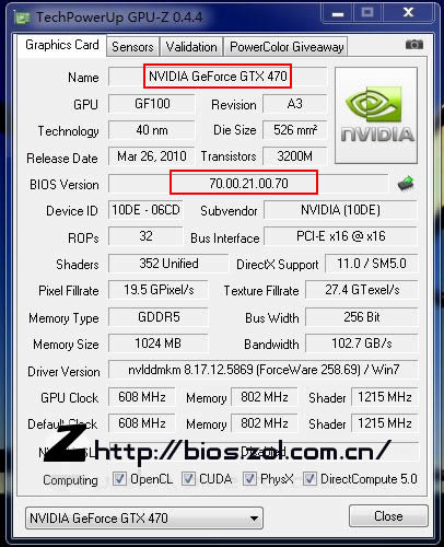

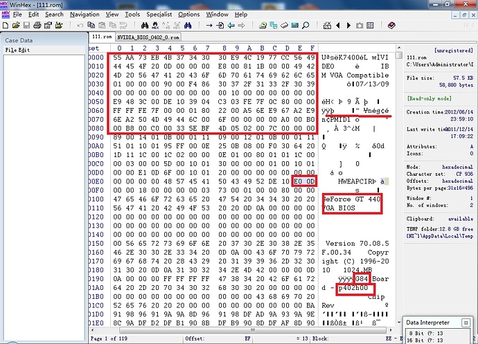

I’m from CHINA,
you can search a software,name:1.BOIS-ID(ONLY CAN CHANGE ID3 AND ID4),2.NVROM(not by nVidia,very very powerful! DIVE ID any to any)
The Virtual goods has be sold in B2C,G84 can Change to GTS450 ,GF104 to GTX560Ti and so on External Image , All the INFO you can change by you want,but only the info.
English is poor,I hope it useful to you.
