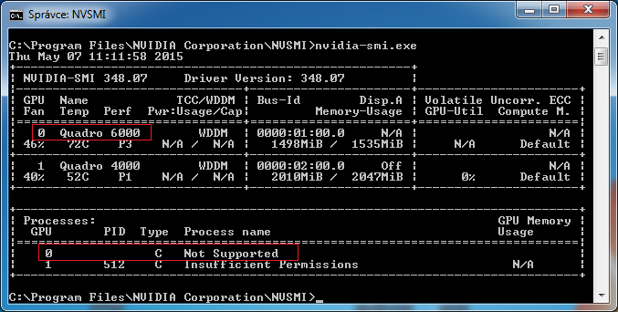

Want to share my part…
I have two 480’s and I need TCC mode for doing GPUDirect
Based on instructions in this thread and this guide:
http://www.davidgis.fr/blog/index.php?Xen/p2
I was able to flash both of them to either Quadro 6000 or Tesla C2050/C2070, they show up in the system as they should, I see bidirectional async engine in CUDA-Z, but I cannot switch those cards into TCC mode by any means.
It looks like this:
I use this driver: Quadro Desktop/Quadro Notebook Driver Release 346 | R346 U4 (348.07) | Windows 7 64-bit, Windows 8.1 64-bit, Windows 8 64-bit, Windows Vista 64-bit | NVIDIA
PC - i7 4790, Win7 Pro x64, running from Intel integrated GPU (so no monitors attached to the nV cards)
I also tried Quadro 4000 (original) on the very same platform and switching it to TCC mode worked. Has nVidia implemented some kind of check into the drivers to detect a flashed card? Or am I doing something wrong?
UPDATE: I tried with an older driver from 2011 and same result, must be something different…
I also have a 580 lying around, I see that someone managed to flash it to M2090, but provided that the straps are stored in the same location as 480, they are kinda weird…
AND0: 0xFFFFFFFF
OR0: 0x00000000
AND1: 0x7FFFFFFF
OR1: 0x80000000
if I want to switch it to Tesla:
GF580 - 80:0 0000
M2090 - 91:1 0001
that means that I need to change OR0 mask to
0x10000400
so the command would be
nvflash --index=0 --straps 0xFFFFFFFF 0x10000400 0x7FFFFFFF 0x80000000
but it gives me “Straps out of range”…
Finally, I managed to turn 580 into Tesla M2090 and switching it to TCC works as well. The trick is that the highest bit in OR mask must be set to zero, the command is
nvflash --index=0 --straps 0x7FFFE7FF 0x10000400 0x7FFFFFFF 0x00000000
I didn’t edit BIOS at all, just softstrapped the card.
