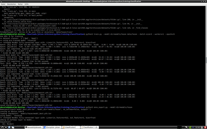

I want to train a network to detect the errors, so I want to create the label file first:
jetson-inference/python/training/classification/data
I have 2 classes bad and good.
for training i have 24 Images for good and 24 Images for bad.
for val i have 6 Images for good and 6 Images for bad.
but for test i don’t have Images because i want just run the camera to test my model. (i don’t know if that makes problem as long as i don’t have photos for testing)
i follow the Steps :
$ cd jetson-inference/python/training/classification
  • Training the Model:
    $ python3 train.py --model-dir=models/Yazan data/Yazan --batch-size=3 --workers=1 --epochs=5
  • Convert the Model:
    $ python3 onnx_export.py --model-dir=models/Yazan
  • Run the Model:
    $ imagenet.py --model=models/Yazan/resnet18.onnx --input_blob=input_0 --output_blob=output_0 --labels=data/Yazan/labels.txt csi://0

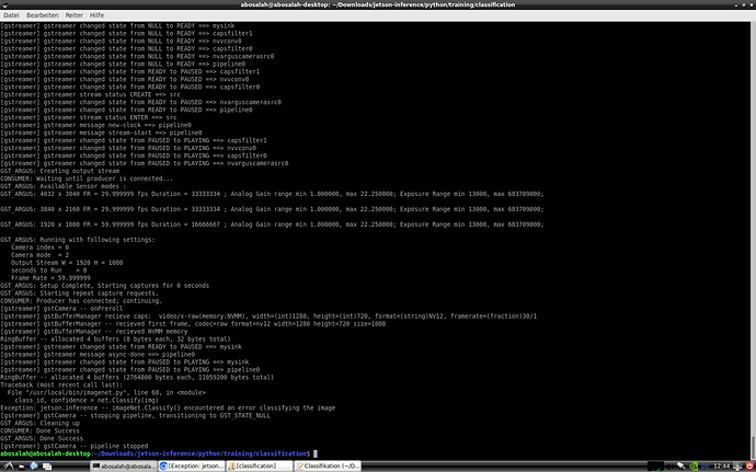

with the last Command i get a problem:
but i want to share for something, when i train my Model the accuracy sometimes is 0
Now there is something new when I want to run my model, but with a new command, instead the command mentioned above:
$ imagenet --model=models/Yazan/resnet18.onnx labels=data/Yazan/labels.txt --input_blob=input_0 --output_blob=output_0 – csi://0
my camera runs well but i don’t came a classification

[gstreamer] gstDecoder – failed to retrieve next image buffer
imagenet: failed to capture next frame

Hi @yazan.doha, when there is no classification made, it means that none of the classes had confidence value > 0 from the DNN. This typically means that the model wasn’t trained fully/accurately or that the source material is quite different from the data that the model was trained on.
I would try collecting more images in your dataset, and also training your model for more epochs (like ~30 epochs, or until it has higher accuracy)
If you re-export your PyTorch model to ONNX, please also delete the *.engine file from your model’s folder, so that TensorRT will use your updated ONNX model the next time you run imagenet program.
I also recommend running imagenet program on some test/val images from your dataset first, just to make sure that the model is working before trying it on a camera.
