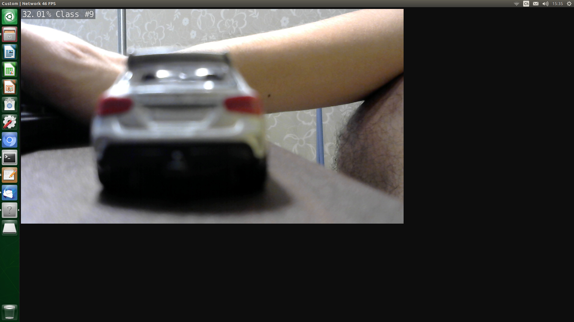

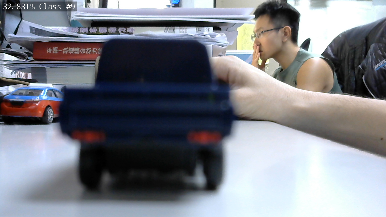

Hello,I am Andy. I stay in Taiwan. I am a student. I want to ask a question. I used this website:jetson-inference/pytorch-collect.md at master · dusty-nv/jetson-inference · GitHub to train my new image file on googlenet. The label.txt are car,doormax,doormid,doormin.When I detect car ,it displayed class #9. How can I solve it?
Do you feed your label file as an input argument into imagenet-camera.py?
imagenet-camera.py ... --labels=$DATASET/labels.txt
I inputed the terminal line:DATASET=/home/andy/hev/jetson-inference/python/training/classification. Then,I inputed: imagenet-camera.py … --labels=$DATASET/labels.txt --camera=/dev/video0. Because my camera is usb camera. But the label is wrong. It should display car.

imagenet-camera --model=GoogleNet-ILSVRC12-subset/resnet18.onnx --input_blob=input_0 --output_blob=output_0 --labels=$DATASET/labels.txt --camera=/dev/video0
It should display car.But the label is wrong.
Hi Andy, recommend that you start with the imagenet-console program first on a test image from your dataset, to make sure that your model is working appropriately. Since it is saying “class #9”, it appears that it isn’t loading the labels file, or that the model has more classes than the labels file.
Is your dataset the GoogleNet-ILSVRC12-subset? Because that has more than the 4 classes you listed above (car,doormax,doormid,doormin)
Can you share the directory structure of your dataset? I ask because it is not typically stored directly in jetson-inference/python/training/classification directly, and also because of the references in your script to GoogleNet-ILSVRC12-subset which are different than the 4 classes you listed.

Please share the terminal log from when you run imagenet-console program, so we can check the inputs/outputs of the network. It would appear that now, there are more than 4 outputs if it is classifying as class #9.

I inputed the line:
          imagenet-console ... --labels=$DATASET/labels.txt
The result is below picture.
And I inputed the line:
 ./imagenet-console 15112019-155105.jpg output_1.jpg
This picture is in /home/andy/hev/jetson-inference/python/training/classification/train/car.

I inputed the line:
imagenet-console --model=GoogleNet-ILSVRC12-subset/resnet18.onnx --input_blob=input_0 --output_blob=output_0 --labels=$DATASET/labels.txt 15112019-155047.jpg output_1.jpg
This picture’s label should display car,but it displays the Class #9.

OK, so in ‘Screenshot from 2019-11-20 22-30-20.png’, it shows that your model actually has 18 classes - not 4.
I would double-check that when you trained the model, you provided the training script with the correct location of your dataset. Somehow the PyTorch training script is finding 18 classes. When you first run the training script, it will print out all the classes it finds (on the line '=> dataset classes: ')
If you continue to have problems, please provide the console log of your training session.

I would make fresh directories for your dataset and new network to avoid any confusion with the GoogleNet-ILSVRC12-subset. Store your dataset in it’s own directory instead of /python/training/classification
Thank you.I solved this problem,because my dataset stored in /home/andy/hev/jetson-inference/python/training/classification/mydataset/car.
