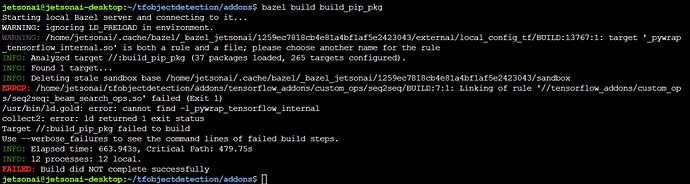

Ive been trying to install TFOD API which apparently needs tensorflow-addons and tensorflow-text. I followed the solutions from:
But the build is failed,
for tensorflow addons :
for tensorflow text:
