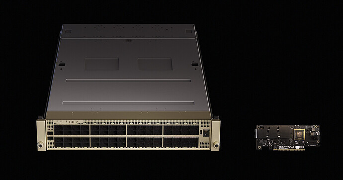

Packet trimming is supported on NVIDIA end-to-end solution based on Spectrum switches with our Spectrum-X solution.
In Spectrum-X E2E solution our NIC HW has the support of ingesting these packets and react on them per the functionality defined in the E2E solution.

Thank you for the link. I have reviewed the white papers on the NVIDIA Spectrum-X Platform, but I have not found any mention of trimming feature. Additionally, all the materials seem to refer to the BlueField NIC, whereas my question specifically concerns the ConnectX-7. Could you please direct me to documentation that describes the trimming feature in the context of NVIDIA? Does this feature work with the ConnectX-7 NIC?
It is supported on Spectrum-X solution. As such it is enabled (under the hood) by the BlueField device.
